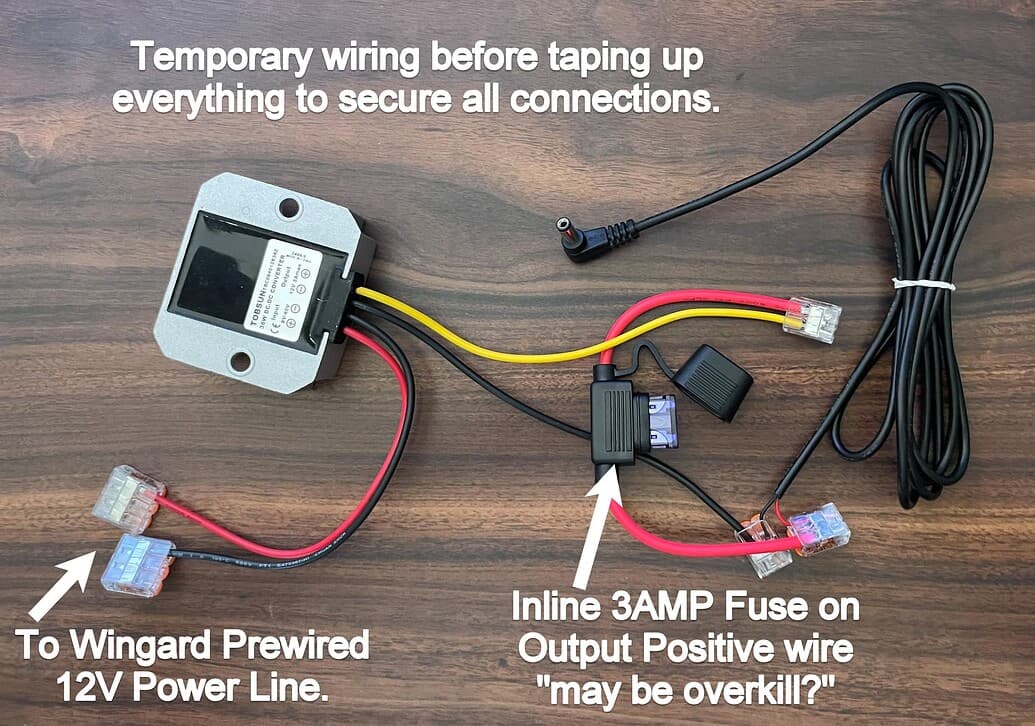

An adapter about this kind of cable:
So based on all of the excellent suggestions from joeinternet and others I purchased the components and have temporarily wired and tested this configuration. My next step is to pull the 12V power line from the ceiling where the prewired Wingard 360 Plus that came with our RV is located and use that as the power source and finally tape up all of the connections. I'll also build a box that will mount near the Wingard port to contain, hide and secure all of these components similar to the Basecamp …

As for the connector, you need a DC 5.5 mm x 2.1 mm connector.
