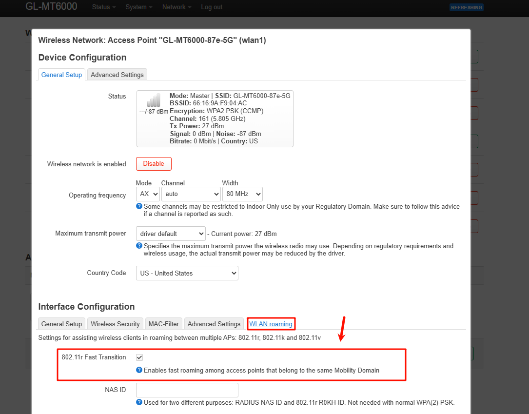

Based on your requirements, we recommend using the op24 firmware version.
Download link: GL.iNet download center
Installation method: Upgrade - GL.iNet Router Docs 4
After installation, you can edit the corresponding SSID under Luci → Network → Wireless to enable 802.11r (802.11k/v is enabled by default).
For DAWN configuration, we suggest following the OpenWrt community guide:
