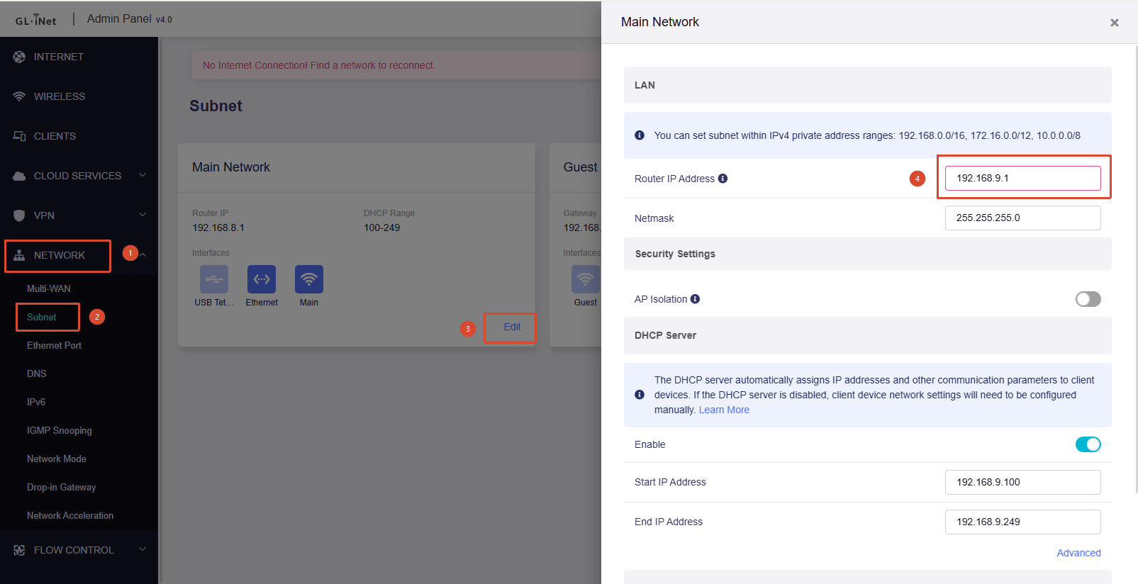

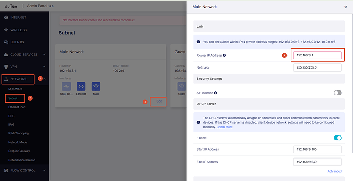

  1. In v4.10.0, the Admin Panel no longer has the Network → LAN page. LAN, Guest, and IoT networks are now managed under Network → Subnet .
  2. If we try to set the LAN IP address to 192.168.9.1 , which is already used by the Guest network, the interface displays an error and does not allow the configuration to be saved.
Could you provide more detailed steps to reproduce the issue? Did you change the LAN IP address using another method, such as LuCI or UCI commands over SSH?

I did not set the LAN IP on 4.10.0. Here's the actual path:
  1. On 4.8.5, Network → LAN, I set the LAN IP to 192.168.9.1. 4.8.5 accepts this without any warning or error.
  2. I then upgraded to 4.10.0 with "Keep Settings" enabled.
  3. The conflicting configuration was carried over as-is. The new validation in 4.10.0 only runs on user input in Network → Subnet — it does not re-validate configuration inherited from an upgrade.
  4. On first boot the guest network was auto-disabled (the menu_lanip warning), but Block-LAN-mgmt-guest was still generated, with src='lan' — locking me out of the admin panel.
So this is an upgrade/migration issue rather than an input-validation one. The guard was added, but nothing checks existing configs on upgrade.

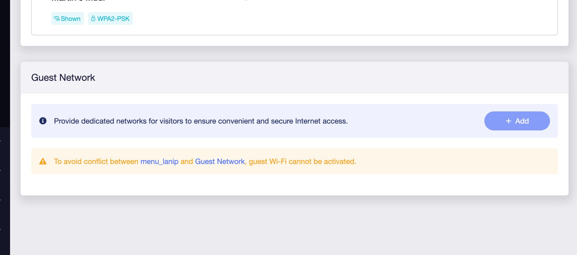

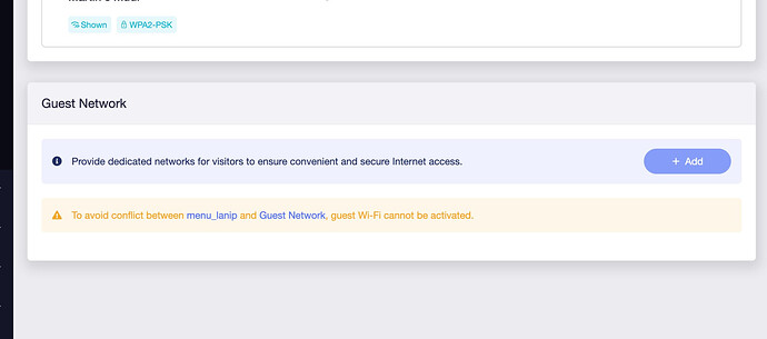

Regarding the untranslated menu_lanip text, could you please let us know which language was selected in the Admin Panel, and on which page or screen did the message appear?
Sure — Admin Panel language: English (EN) Where it appeared: the WIRELESS page, in the Guest Network section — the yellow banner directly below the "+ Add" row. Not under Network → Subnet; that page just showed the addresses with no warning. Full text as displayed: "To avoid conflict between menu_lanip and Guest Network, guest Wi-Fi cannot be activated." The surrounding sentence is translated fine — only the `menu_lanip` placeholder renders as the raw key instead of the LAN IP value (or the "LAN IP" label) it is meant to interpolate. Firmware: 4.10.0 (release), GL-E5800. It only appears while LAN and Guest hold the same address, i.e. the same broken state as the main issue — so it should show up in the repro you just ran. First screenshot is that state. Second screenshot is after moving LAN to 192.168.6.1: Network → Subnet now shows Main 192.168.6.1 / Guest 192.168.9.1, no conflict, and the banner is gone from the Wireless page.
