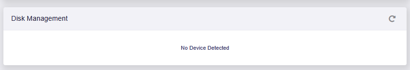

Both R&D and I have tested (different USB drive), and USB 2.0 has not been reproduced. :thinking:
I have a USB 3.0 hub connected to the Brume 2 USB 3.0 port, this one:
https://www.amazon.de/dp/B0CD1BHXPZ
And on it a Sandisk USB 3.0 flash drive 32GB
and a USB 2.0 printer (which is off though all the time). I also installed the package p910nd as print server, not sure if that has anything to do with it. The issue was introduced with 4.7.0 on Brume 2 and also seems to exist in 4.7.4.
I never changed the setting to usb 2.0 though. For me the problem is with the default setting.
I don't have a USB Hub here, but directly connect the USB drive to USB, and it will be automatically mounted after router restarted. It has not been reproduced.
Under factory settings, please try to remove the USB Hub and directly connect to the Sandisk drive to the Brume USB port. Will the restart automatically mount?

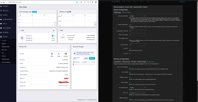

root@GL-MT6000:~# lsusb
Bus 001 Device 001: ID 1d6b:0002 Linux 6.6.69 xhci-hcd xHCI Host Controller
Bus 001 Device 002: ID 058f:6387 Generic Mass Storage
Bus 002 Device 001: ID 1d6b:0003 Linux 6.6.69 xhci-hcd xHCI Host Controller
root@GL-MT6000:~#

That is not an option. It is a normal usb 3.0 hub, which I also need because I have multiple usb devices on the Brume. I just rebooted my Brume 2 yesterday again a few times, and now today I notice the usb device is again missing
Removing the flash drive and plugging in back, and it is back.

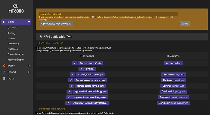

My log file is filling up with this:
Tue May 20 19:23:21 2025 daemon.err eco[22588]: call wifi.get_config fail with http code: 302
Any ideas?

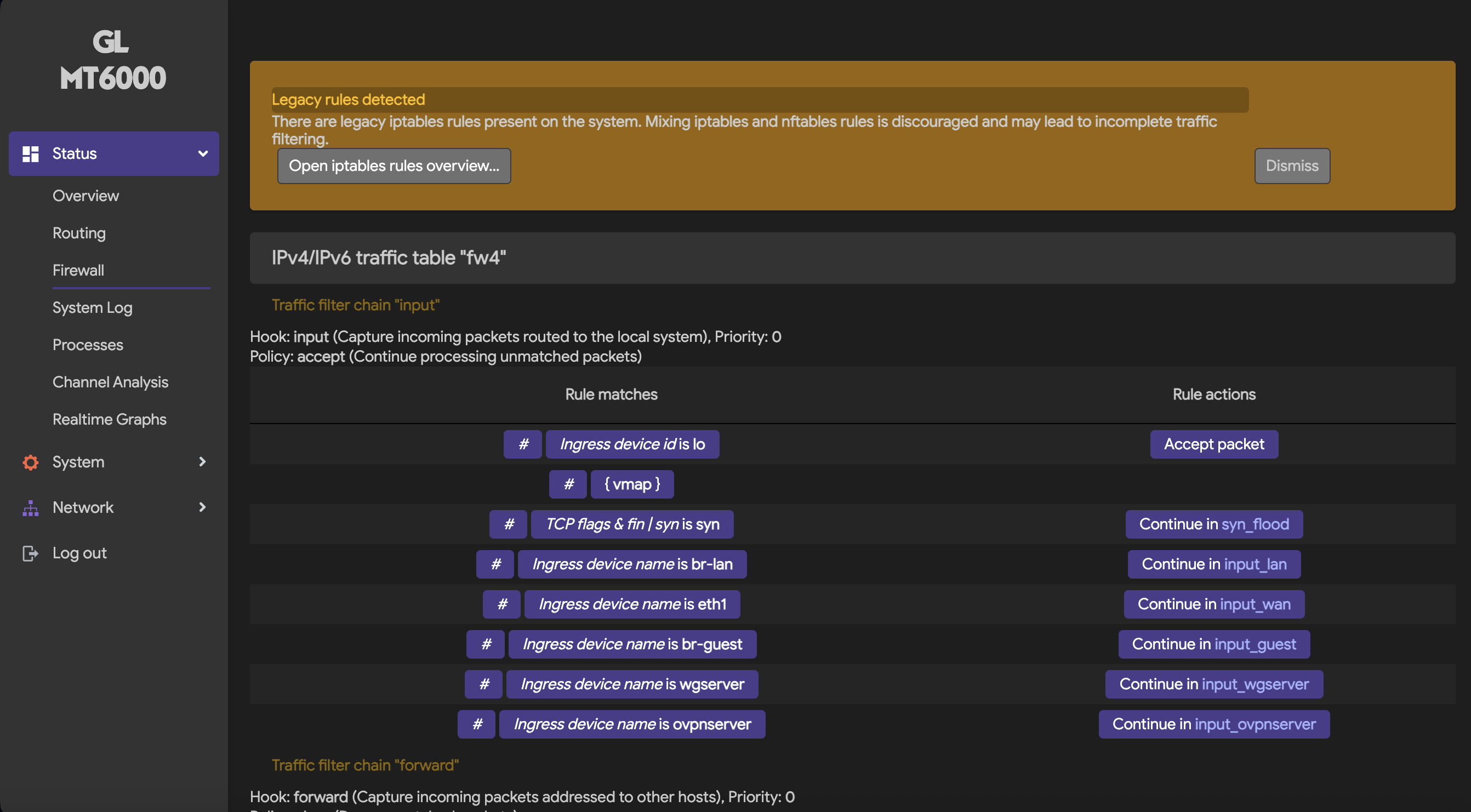

In LUCI, there is this warning:
Legacy rules detected
There are legacy iptables rules present on the system. Mixing iptables and nftables rules is discouraged and may lead to incomplete traffic filtering.
Is this normal?
Anyone has this too?
Good, we getting there, hopefully I can get out 4.6.6-op24 soon :person_shrugging:
Hi again,
For the warning "Legacy rules detected", I've got this:
root@GL-MT6000:~# iptables -S
-P INPUT ACCEPT
-P FORWARD ACCEPT
-P OUTPUT ACCEPT
-A FORWARD -m set --match-set GL_MAC_BLOCK src -j DROP
root@GL-MT6000:~# ip6tables -S
-ash: ip6tables: not found
It seems this ipatble rules doesn't exists in nft version.
Can the old iptable rules be deleted without consequences?
Or must it be converted into nft?
iptables may not be adapted well, but it does not affect the router networking, actually the rules didi not take effect.
Temporary workaround:
iptables -w -D FORWARD -m set --match-set GL_MAC_BLOCK src -j DROP
iptables -w -t mangle -D PREROUTING -j VPN_SER_POLICY
