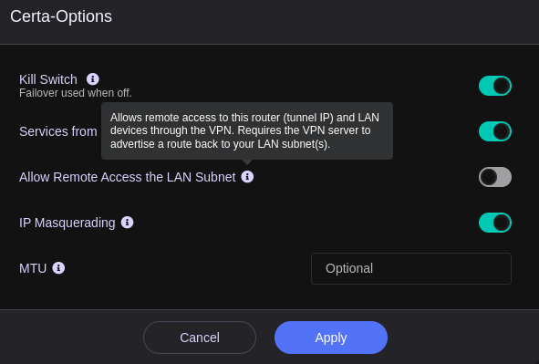

This is from a Slate AX (GL-AXT1800) running v4.8.0-beta9 as a WG Client:

The 'server' needs to serve a route back to the client for a S2S. That has not been determined to be configured.

If want to access from server router side TO client router LAN through client router LAN subnet, it required to add a route rule in server router.
If only access the client router GUI, not required to add the route, direct use client tunnel IP like 10.x.x.x.
