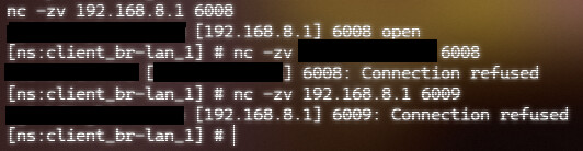

In this case what does it mean? 6008 is my webdav port while 6009 is a bogus and closed one (second row is WAN IP port test)
