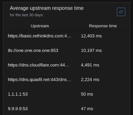

Flint 2 running 4.8.3 and latest AGH version (v0.107.69)
Quad9 DoH

Any idea why AGH reports such high numbers in the interface for encrypted protocols?
This appears to be a known issue with AdGuard Home:
Very slow and increasing "Average upstream response time" · Issue #6818 · AdguardTeam/AdGuardHome · GitHub
Please try restarting the router to clear the AdGuard Home logs and then observe whether the slowdown continues.
If you are using the admon script and have enabled persistent logs, be sure to delete the stored log files as well.
If DoH/DoT response times are still slow afterward, you can SSH into router, measure the actual query processing time with the commands below and check if it matches what ADG Home displays.
If it does, it may be a network issue.
For DoH:
while true; do /usr/bin/time -f "Query Time: %e seconds" dig +https @cloudflare-dns.com google.com > /dev/null ; sleep 1; done
For DoT:
while true; do /usr/bin/time -f "Query Time: %e seconds" dig +tls @one.one.one.one google.com > /dev/null ; sleep 1; done
