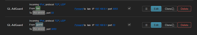

Hi, my Flint2 and Flint 3 are connected via the WAN port to my main router, and received an IP like 192.168.1.111. In the past, I was always able to start AdguardHome (Version: 0.107.56) and test the upstream server and update the block list. That's not possible anymore.
I am able to ping a server in the console.
Since OP24 4.8.0 (for Flint2) I receive the following error message when updating the block lists:
Error: control/filtering/add_url | Couldn't fetch filter from URL "https://adguardteam.github.io/HostlistsRegistry/assets/filter_48.txt": reading from url: Get "https://adguardteam.github.io/HostlistsRegistry/assets/filter_48.txt": resolving "adguardteam.github.io": all upstreams failed to exchange request: exchanging with 176.9.1.117:53 over udp: read udp 192.168.1.7:48499->176.9.1.117:53: read: no route to host exchanging with 176.9.93.198:53 over udp: read udp 192.168.1.7:42944->176.9.93.198:53: read: no route to host all upstreams failed to exchange request: exchanging with 176.9.93.198:53 over udp: read udp 192.168.1.7:58073->176.9.93.198:53: read: no route to host exchanging with 176.9.1.117:53 over udp: read udp 192.168.1.7:44342->176.9.1.117:53: read: no route to host | 400
Is anyone having similar issues, or am I the only one?
@bruce, is this error familiar to you?
Update, 02.08.2025: Fun fact: When I attach a tethering device, I can update the AdGuardHome blocklist and I can test the upstream server. There is definetly something wrong with the firewall config in the new software release.
Solved. My main router was blocking DNS traffic :woman_facepalming:
