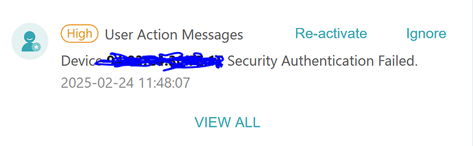

I am now getting "Security Authentication Failed" for the client I am trying to use. This is what I see in the message center on GoodCloud.
I have disabled and re-enabled GoodCloud. I did click "Re-activate" in the message but it gives me the same error. I have also removed it and re-added the device in GoodCloud.
Please take a look into the local cloud logs.
