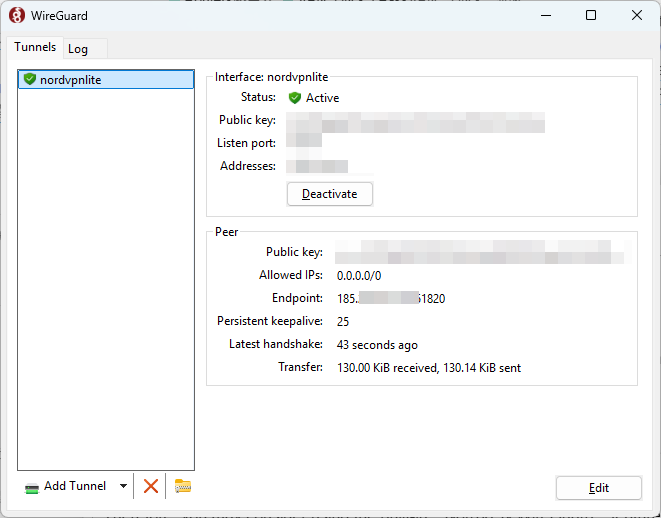

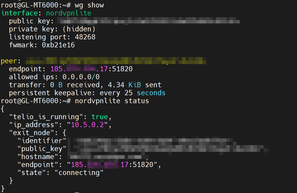

We tested this locally on the MT6000, and it appears that the client is using standard WireGuard directly.
The exported configuration file can also be used on other devices with a regular WireGuard client.
Therefore, you may consider using the built-in NordVPN WireGuard feature already integrated into our firmware.
