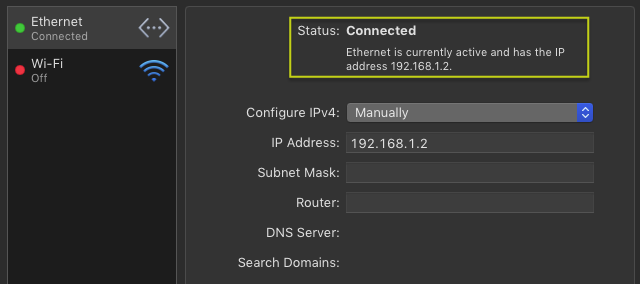

IP 192.168.1.2
manually set IP
nothing at http://192.168.1.1/ using safari which has no cache, no extensions, no nothing
Screen Shot 2021-05-17 at 1.24.20 AM
