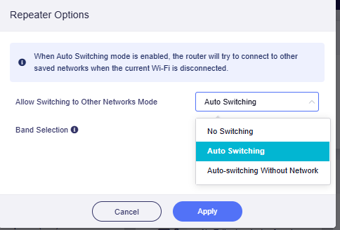

Under "Repeater Options", what should "Allow Switching to Other Networks Mode" and "Band Selection" be?

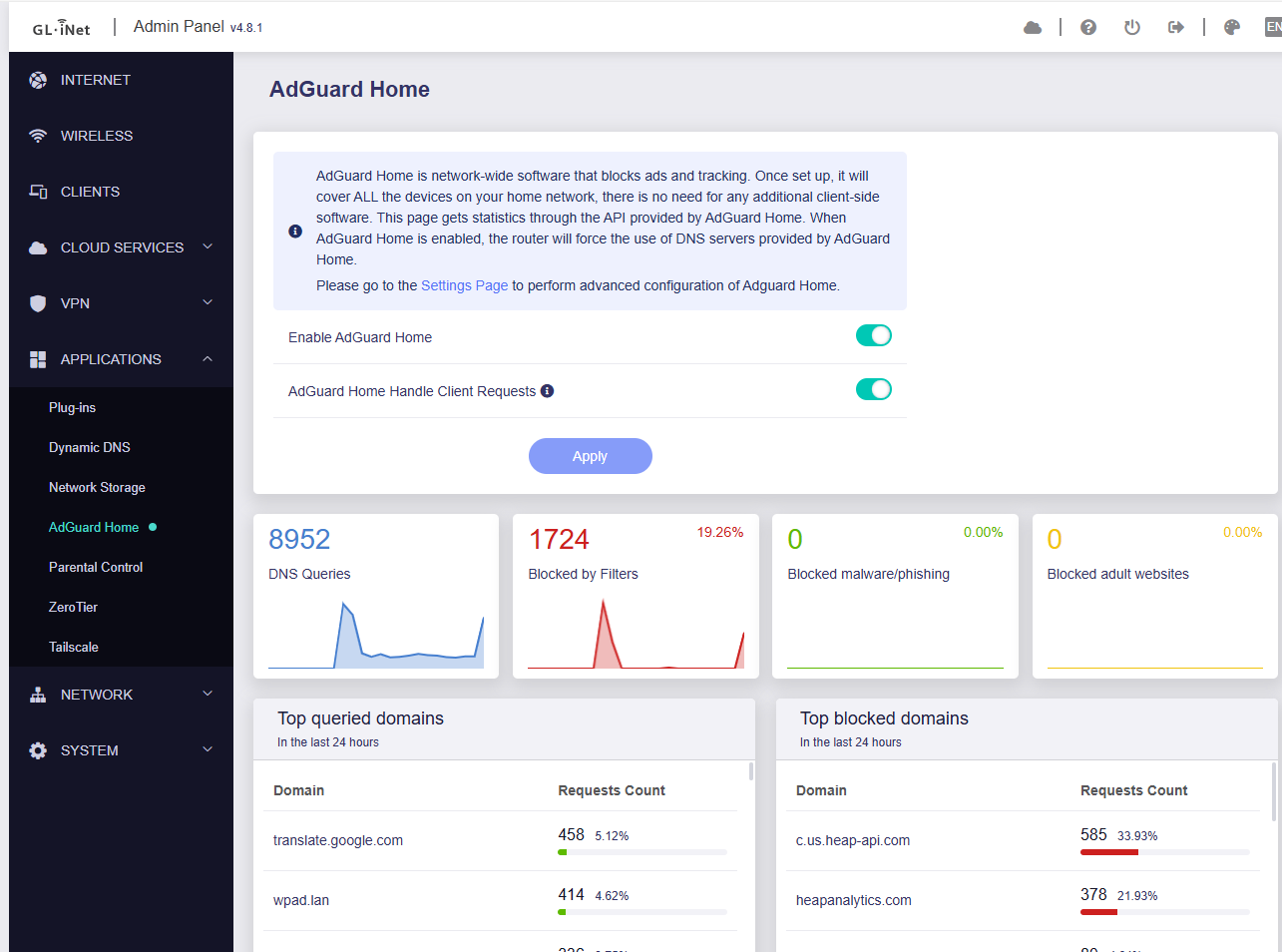

Under Adguard Home's DNS Settings, is "Load-balancing" the best option? Should I leave "Fallback DNS servers" blank? Should I leave "Bootstrap DNS Servers" with the default settings? I only see a bunch of numbers. "Private reverse DNS servers" is blank. "Use private reverse DNS resolvers" and "Enable reverse resolving clients' IP addresses" are enabled. Everything else is at the default.

How do I check how much RAM is being used by all of the blocklists I have enabled in AdGuard Home?

You can select different settings based on your needs, and a description of the function will appear at the top of the interface.
It is recommended to select the automatic mode for the frequency band.

You can view the intercepted data through the ADGuard management page
