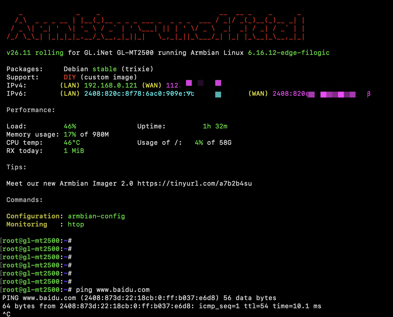

Hi everyone,
I have been working on Armbian support for the GL.iNet GL-MT2500 (Brume 2), and the source code is now available here:
The goal is to let the GL-MT2500 run a standard Debian/Armbian userspace while keeping the original OpenWrt installation available as a fallback.
Current status
The complete build and installation procedure below has been tested on GL-MT2500 v1 (MaxLinear 2.5G PHY).
  • Debian Trixie CLI image
  • Linux 6.16.12-edge-filogic
  • U-Boot 2025.04
  • Armbian root filesystem on a USB drive
  • No case opening or serial connection required for the normal installation
  • Automatic fallback to the original OpenWrt system on eMMC if USB boot fails
  • The original eMMC OpenWrt system, BL2, environment and RF calibration data remain in place
  • USB storage drivers are included in initramfs
The source tree also contains a gl-mt2500-v2 board configuration and Airoha EN8811H firmware handling. However, the installation procedure and reference image documented here are for v1. Do not use a v1 image on v2 hardware.
This is an unofficial community port. It is not an official GL.iNet or Armbian release.

The first Armbian boot expands the root filesystem and asks you to set a root password and create a normal user.

Thanks for your work on this and for sharing it with the community. The detailed instructions and OpenWrt fallback design will be helpful to users interested in running Armbian on the Brume 2.
At the moment, only the U‑Boot on the device needs to be adjusted. The Armbian system resides on a USB drive – simply unplug it and the device will boot into OpenWrt. If you ever need to restore the original U‑Boot, you can reflash it from either OpenWrt or Armbian. By the way, I've submitted a PR to the official Armbian repository, which has been approved and is expected to be merged soon.
It did take quite a bit of time. I've had this idea for a long time, but never found the right moment to start. Recently I finally managed to set aside some time, and with the help of large language models, I got it done – though I spent a lot of effort on debugging, especially repeatedly flashing the device. Luckily, the outcome turned out pretty well.
Also, as far as I know, GL.iNet has another model called the GL‑MT5000, which also looks like a good candidate for Armbian. I hope that enthusiasts who have access to the device will give it a try – after all, Armbian is a full‑featured Linux distribution and offers much more room for experimentation.
