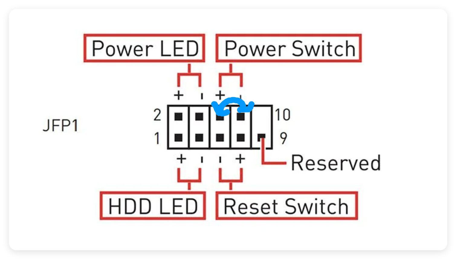

If still not work, try reversing the polarity of POWER SW (The pins that connect to the motherboard )
Thank you for replying. Got home and tried the solution, and it worked. Weird that I was able to still reset and turn it on using the buttons on the front panel. Question how do I check the firmware on the board and how do i flash it (if it ever needs to be).

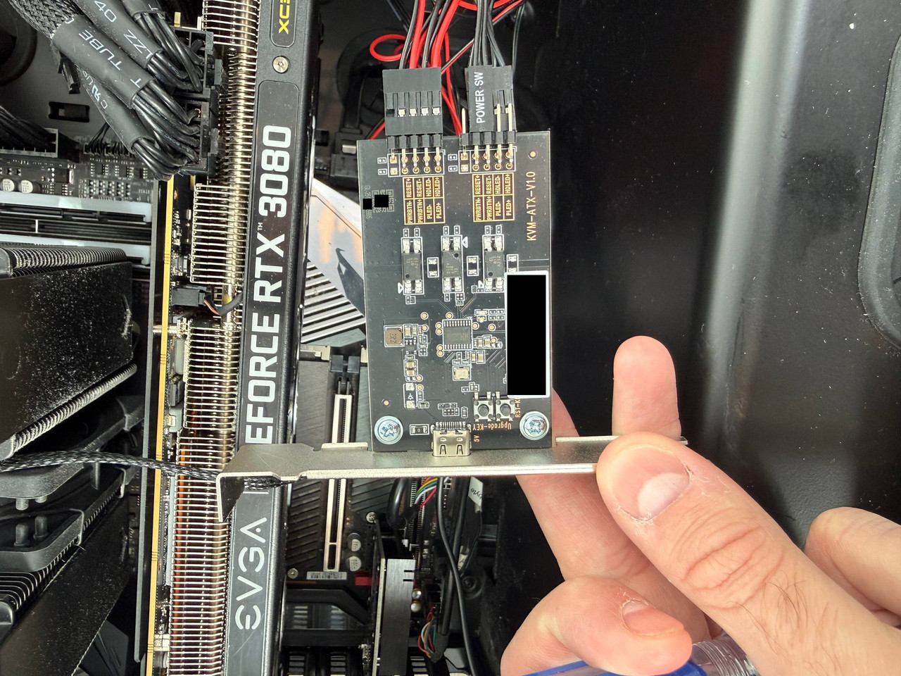

Could you pls show a pic of your connetions?
I was originally experiencing the same issue (Short/Long Press commands weren’t working, even though everything else was functioning properly), but it started working after I reconnected everything.
I used the alternative PWR_LED instead of PLED because I typically have another device connected to the PLED header.
Motherboard: Gigabyte X570 AORUS ULTRA (Rev. 1.2) with 20-5 pin F_PANEL layout
Case: Phanteks Enthoo Pro Tempered Glass ATX Full Tower
Remote KVM: GL-RM1
ATX Board: GL-ATXPC
Here are some pictures:
GL.iNET KVM Docs (GL-ATXPC / ATX Board) also has official pictures for comparison.
To me the led layout is always:
A B
POWER SW +PLED | -PLED
RESET Drive Status Led
On multiple pcs I had over time this exact layout, the pitfalls with this however is that sometimes the PLEDs are so tiny that the Power SW which often is more than 1 pin, skipped a pin and one PLED is on a single pin of the power SW and the other PLED is on the last pin.
^ (It's rare if it differs for the layout)
This means there is one pin free in the middle you barely see, I 100% of the time make this mistake when assembling new pcs, with atx boards especially I never change power SW or reset pled, I first check these single pin ones.
But the polarity of the +PLED and -PLED sometimes need a change so they are inverted.
The only difficulty I had was that there was also a second row with pins on the atx board which confused me, it was not clear to me which part of the two was designed for the case leds and which part was for the atx controller to the motherboard.
I believe I had it on the first right for the case and the second row for motherboard.
What I also recommend is keep it lose, you can try forcing some leds, if power sw works as expected you can check reset, that is how I did it initially, you can also change the parity on the atx board if that had better access. :slight_smile:
