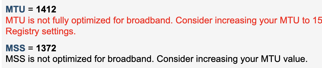

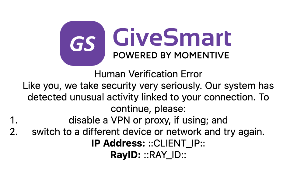

Now the issue is that some websites / CDNs have started detected VPN usage, I presume based on the MTU. For example https://johnoliversjunk.com/
And it’s clear that it’s possible for websites to detect your MTU http://speedguide.net:8080/
And that’s a tell-tale of someone using a VPN. It can also be used by your employer to detect that you’re using a VPN.

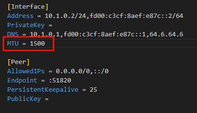

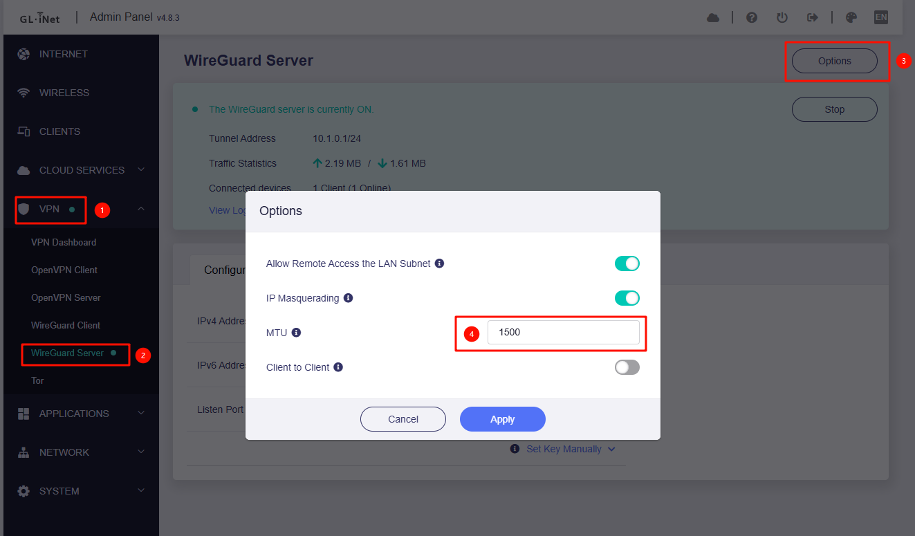

However, if you believe modifying the MTU is necessary, you can
on the server side:
and then update the exported WireGuard profile by setting the MTU value to 1500
