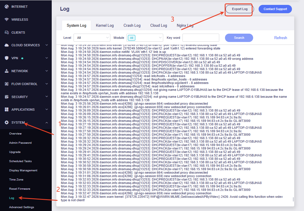

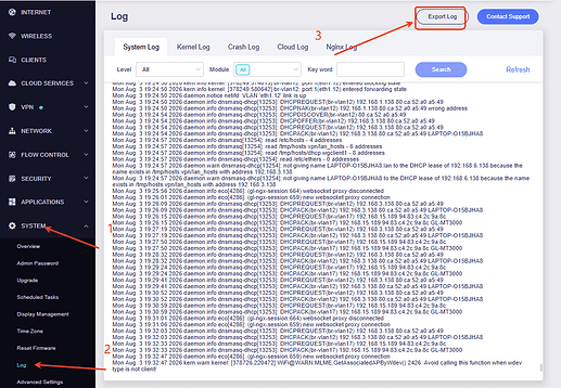

If the issue persists, please plug and unplug the Ethernet cable several times, then export the log from SYSTEM → Log → Export Log and send it to us via private message.
This will help us check whether the router detects the Ethernet connection and disconnection events.
