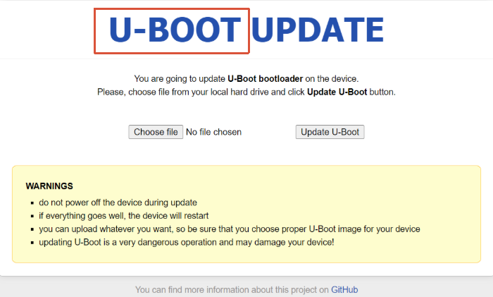

When you installed the vanilla OpenWrt firmware, did you also flash the OpenWrt U-Boot?
If so, you'll need to switch back to our GL.iNet U-Boot before you can successfully install the GL.iNet firmware again.
uboot-gl-b1300-s1300-b2200-20201014-md5-9129f7b5bdc8161b5e2b4924bae1ca35.bin (509.2 KB)
Yes, I tried flashing it but it runs into the same error as flashing the firmware…what can I be doing wrong? I followed this guide: What should I do if my router is bricked - GL.iNet Router Docs 4
The URL for flashing the U-Boot is slightly different: http://192.168.1.1/uboot.html.
Please refer to the following guide for detailed instructions:
