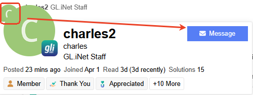

If Bark still shows Connecting..., could you please export the System Log and send it to us via private message so that we can check the router status after startup.

After reproducing the issue, please do not reboot the router. Please go to SYSTEM → Log, click Export Log, and send the exported log file to us via private message.
