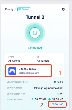

Could you please temporarily disable the second tunnel, reconnect the original tunnel, and share the profile order screenshot and its connection log with us?
Could you also check whether the original tunnel can use Profile B stably, while the other tunnel can use Profile A stably when they are tested separately? Do they consistently select the same profiles after reconnecting?

You may refer to the following content.
