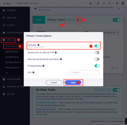

Could you provide a screenshot of Admin Panel → VPN → VPN Dashboard so that we can understand how your VPN is configured?

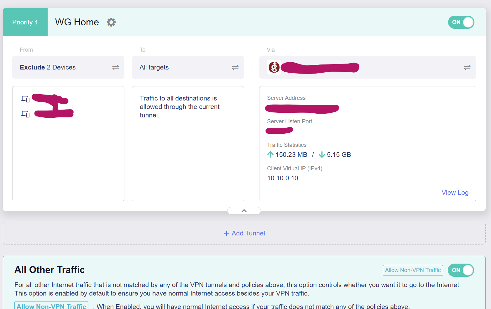

Screenshot attached of tunnel but also note when enhanced kill switch is on, it STILL routes traffic via the real ip (it doesnt stop traffic).
This suggests the router itself thinks the VPN is still connected.

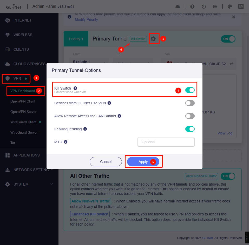

From your screenshot, it looks like the Kill Switch hasn’t been enabled.

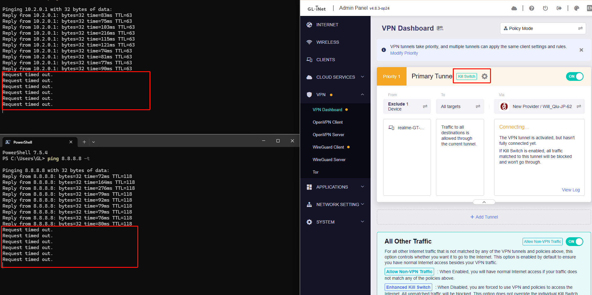

Please try to turn in on and see if the issue happens again or not.
Under normal circumstances, if the Kill Switch is enabled but the VPN is unavailable, traffic will not be able to exit to the internet.
(The Dashboard status update may take a bit of time to avoid frequent interface UP/DOWN caused by minor network fluctuations.)
