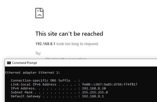

Try setting the computer LAN to IP 192.168.8.10 and gateway IP 192.168.8.1, then see if you can access 192.168.8.1.

results_Capture
still not able to access 192.168.8.1
Does your pc has multiple Internet connections? Can you disconnect other connection and only connect to the router?
Also check if you have vpn on your pc. Disable it if you want to access the web panel.
