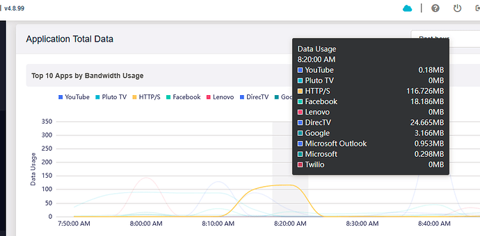

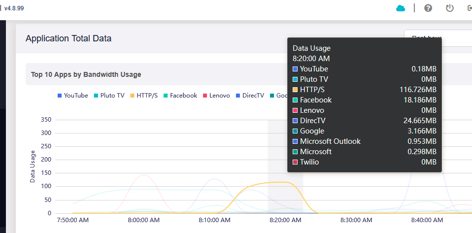

In the DPI graph I would like to be able to hover over a line on the graph and have only its information shown. In this screenshot, I’m hovering over the yellow line but it’s still showing multiple traffic types. Optimally it would only show HTTP/S since sometimes the color differences are so subtle it’s hard to differentiate. It would also help those people who may have issues with colors overall.

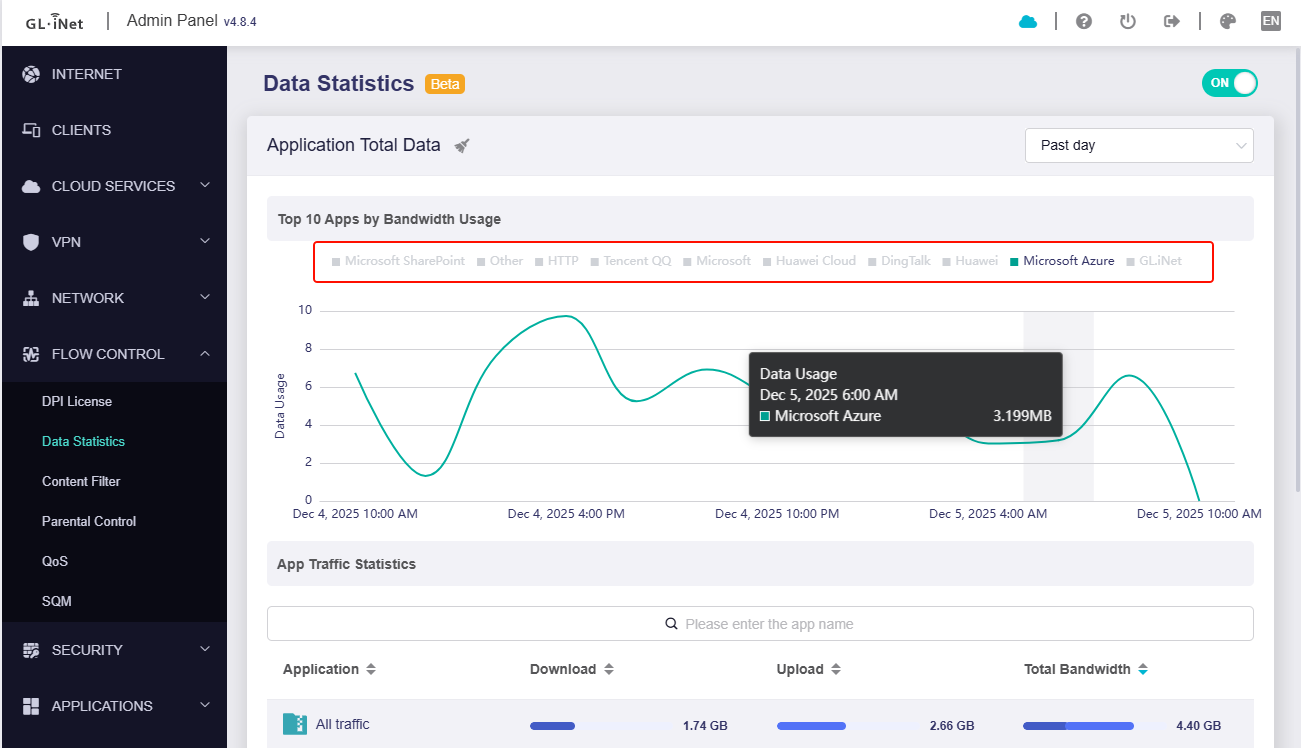

I think we have to click above first to (reverse) filter out the Apps we want to see. There is only this App information in the Data Usage.

Right, but you still need to match the colors. It would be MUCH easier just to hover over the graph line you are interested in. More of a “nice to have one day” than anything immediate.

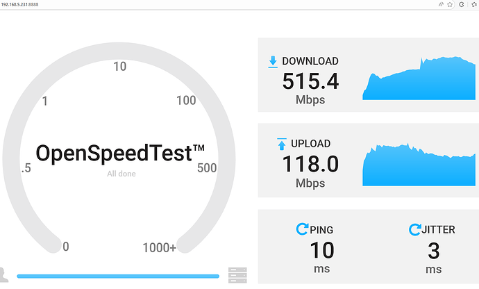

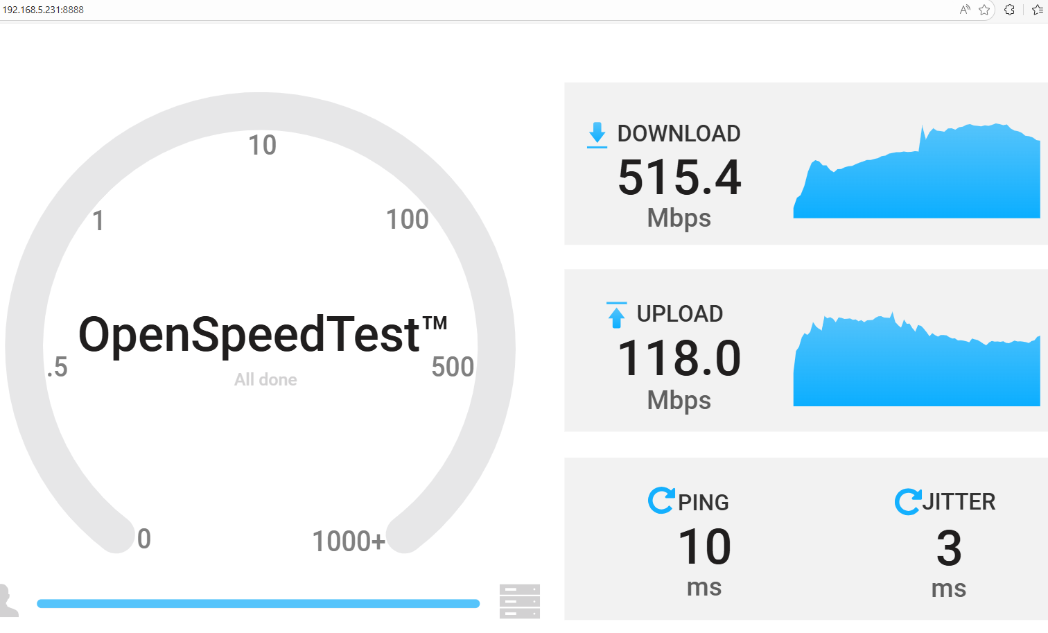

An OpenSpeedTest Server is installed on the NAS, which is connected to MT6000 LAN.

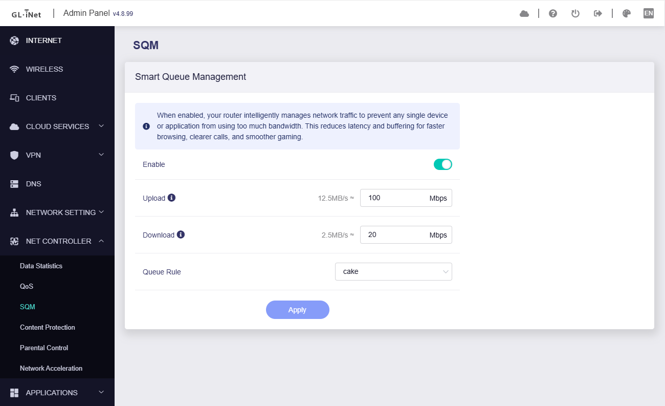

MT6000 enables SQM and sets to 100/20.
The wireless client accesses the OpenSpeedTest webpage (NAS), and the speed are normal:

Maybe SQM or QoS have set the wrong numbers?
