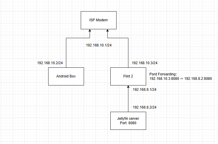

May we know what is your specific network topology?
If both the Android box and Flint2 are connected to the ISP modem, then they should both be on the 192.168.10.0/24 subnet.
Then you should be able to expose the Jellyfin service for use by the Android box by configuring port forwarding on Flint2.
The simplified topology is as follows:

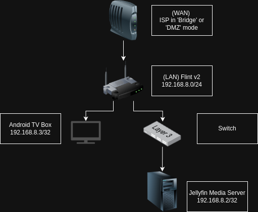

I don't understand. Why would the Android box need to be segregated by physical distance from the Flint v2 & the extra switch attached to it?
How many wired/Ethernet connections do you need for your LAN? The Flint v2 has five LAN-assignable ports. If you keep the switch to act as the extension at the other end of that 90' run your Jellyfin box can just link to the Flint v2 thru that. The Android box would link into a port on the Flint v2.
Per @will.qiu 's diagram the Android box would be something like 192.168.8.3/32. The Jellyfin box would have the switch between it & 192.168.8.0/24's router (Flint v2 @ 192.168.8.1) to extend that Cat. cable run. The ISP unit would just be a 'dumb modem'... as it should be & removes the double NAT deficiency.

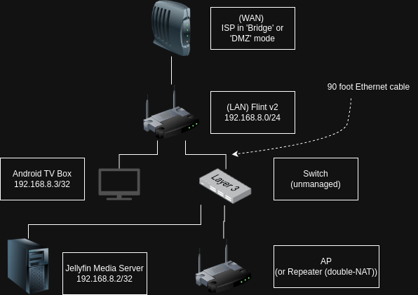

… but you’re already running a 90’ cable now, aren’t you? Is that run already between the modem & the Flint v2? If so move the Flint v2 near the modem & use the 90’ cable to run the switch. Hang a cheap AP off the switch if Wi-Fi won’t reach fr the Flint v2 &/or put it into ‘repeater’ mode. At least then the double NAT would be limited to the repeater’s Wi-Fi subnet.
Use static IP/DHCP reservations on the Flint v2 for IP/hostname management. Boom. Done.
