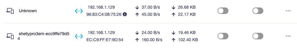

I’ll attach a screenshot from the client list. The shelly is also automatically assigned by the brumes DHCP server. But as soon as I plug in the mango it gets assigned the same IP and the resulting IP address conflict makes both devices unreachable.

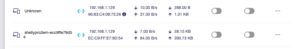

Which is kind a surprise because these are the screenshots I took at the same time:
The interface of the brume
(Here should be the screenshot of the interface of the mango, but as a new user I can only upload one embedded screenshot, but the mango also show .129 as its IP)
