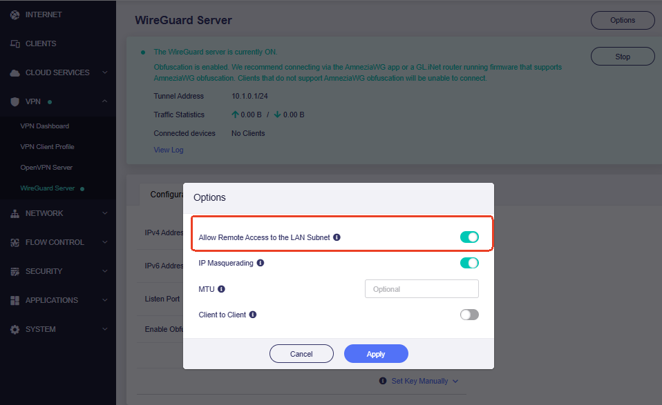

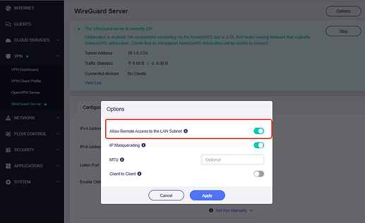

Thank you for the detailed investigation and for sharing the workaround.
We tested this locally on an MT5000 running firmware v4.9.0 but were unable to reproduce the issue. When Allow Remote Access to the LAN Subnet is enabled in the VPN Server settings, the dest='lan' option is generated correctly.

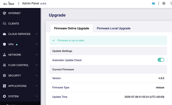

That’s not reassuring for me :sweat_smile:
I flashed the version offered by the router itself, via the Firmware Online Upgrade tab on the router.
And yes I keep the settings. I’ve got too much DHCP Address Reservation set to erase all of this.

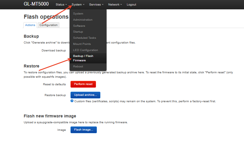

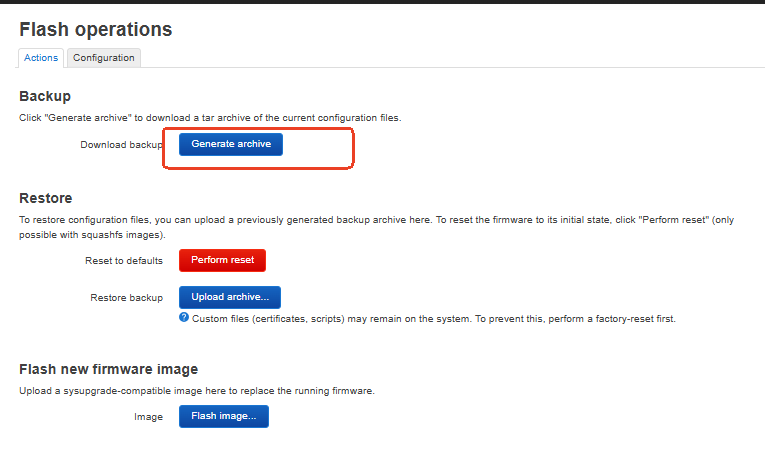

We understand that you have configured many DHCP address reservations. To protect these settings, you may create a configuration backup through LuCI:
  1. Open SYSTEM → Advanced Settings in the GL.iNet Admin Panel and enter LuCI.
  2. Go to System → Backup / Flash Firmware. Under the Backup section, click Generate archive and save the downloaded backup.

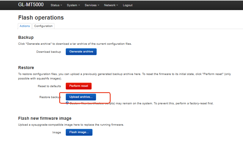

  1. In LuCI, go to System → Backup / Flash Firmware. Select "Upload archive..." and upload the previously created backup file.
