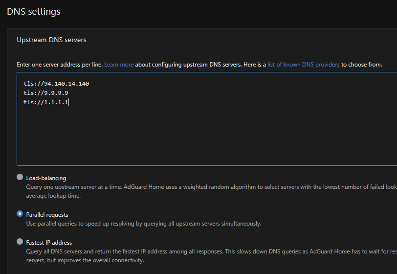

I have not changed much on the Brume configuraiton, I am using AdGuard
