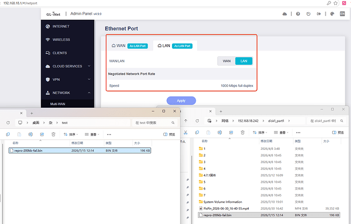

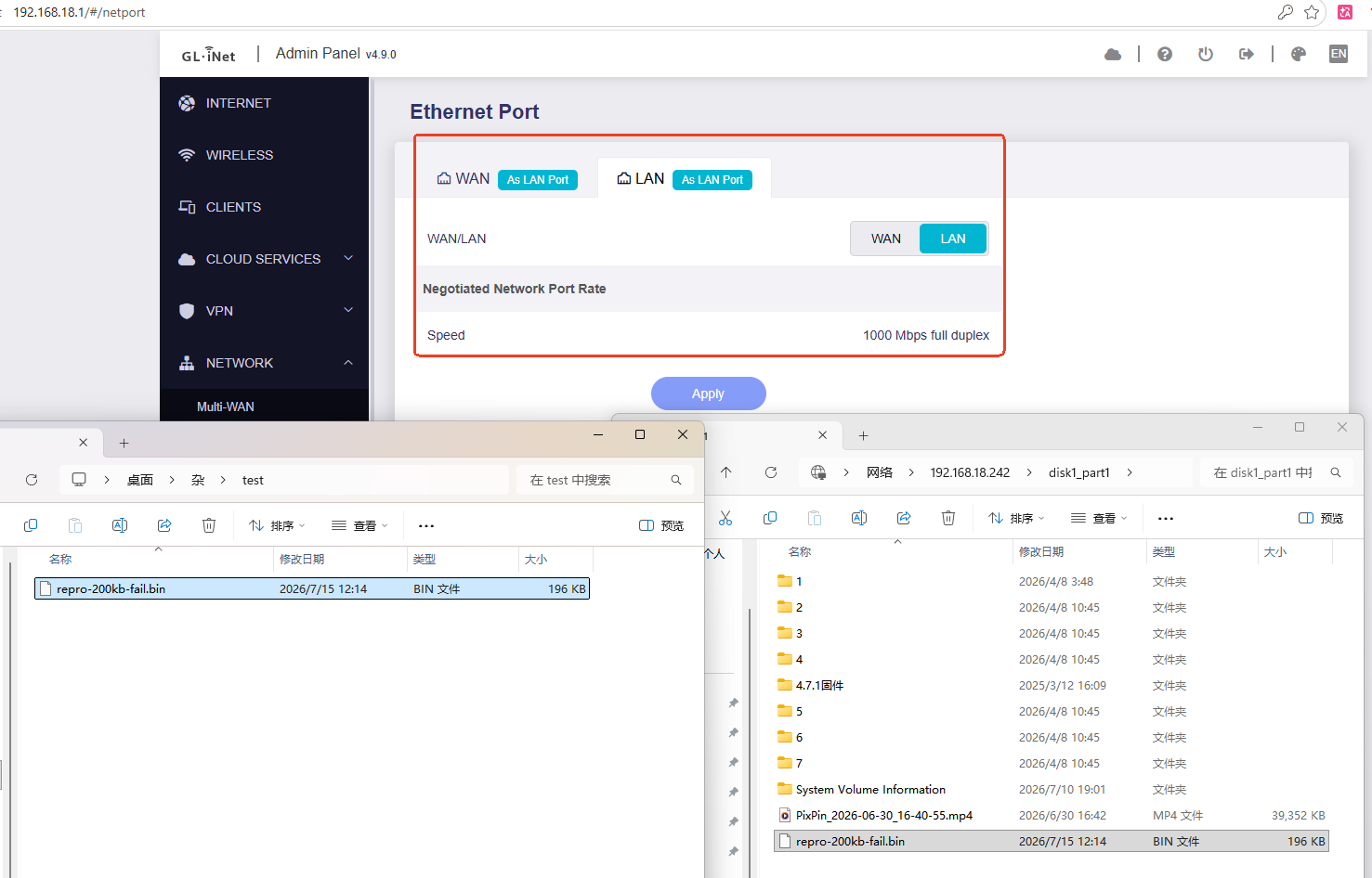

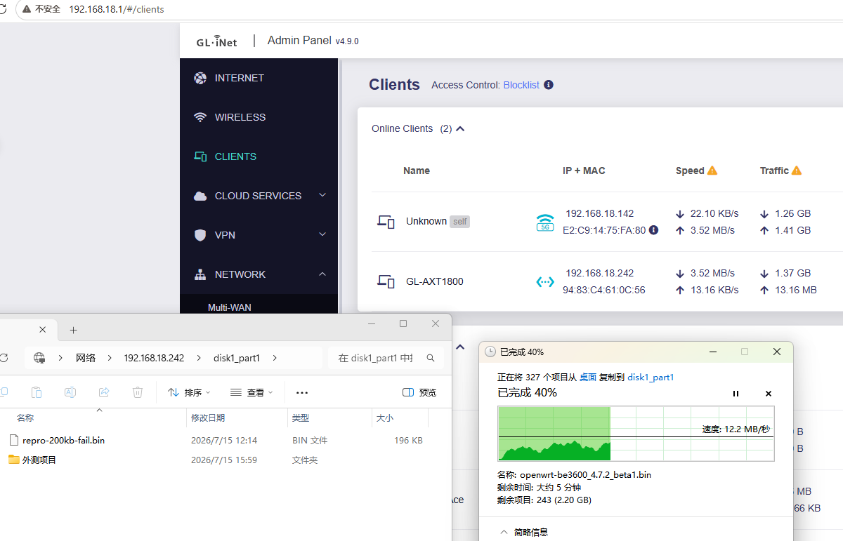

I apologize for the delay; I don't have a NAS device to test on the local network. Sorry.
Therefore, I used a router and a USB drive to set up network storage to simulate the test environment.
The test topology is as follows:
BE6500 ---- WiFi --->> MT3600BE ---- WiFi -—> PC
BE6500 ---- WiFi --->> MT3600BE ----LAN/WAN-—> NAS
I kept most of my MT3600BE at factory default settings.
I moved the file repro-200kb-fail.bin from your first post from my PC to the NAS.
It seems to work fine regardless of whether my NAS is connected to the WAN or LAN port.
This test scenario should be the same as yours, right? If I understand correctly.
I also tested copying a file of about 4GB from my PC to the NAS, which also completed successfully.
