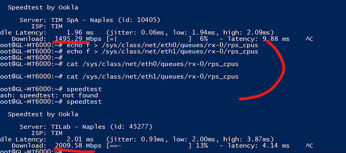

Temporary workaround and screenshot
Manually restoring f/f immediately restores approximately 2 Gbit/s without restarting PPPoE:
echo f > /sys/class/net/eth0/queues/rx-0/rps_cpus
echo f > /sys/class/net/eth1/queues/rx-0/rps_cpus
The attached screenshot provides an additional visual demonstration of this temporary recovery: router-local throughput returns to approximately 2 Gbit/s immediately after restoring the two f masks, without restarting the WAN or PPPoE session. The screenshot tests were interrupted and selected different nearby servers, whereas the controlled results above used the same fixed server and completed tests. The commands confirm the RPS masks as the cause, but they are only a temporary workaround because a later WireGuard/network event can overwrite them again.
