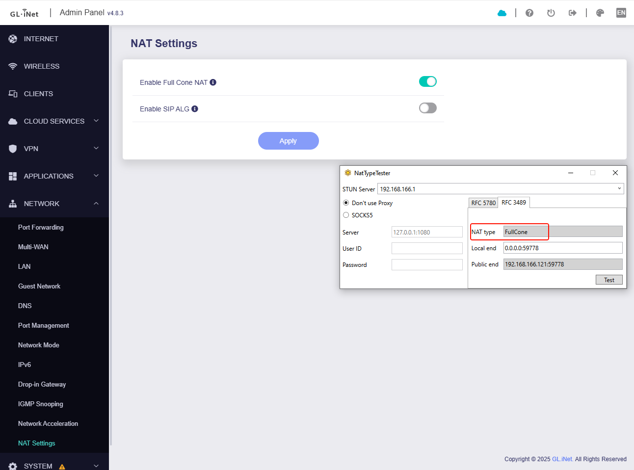

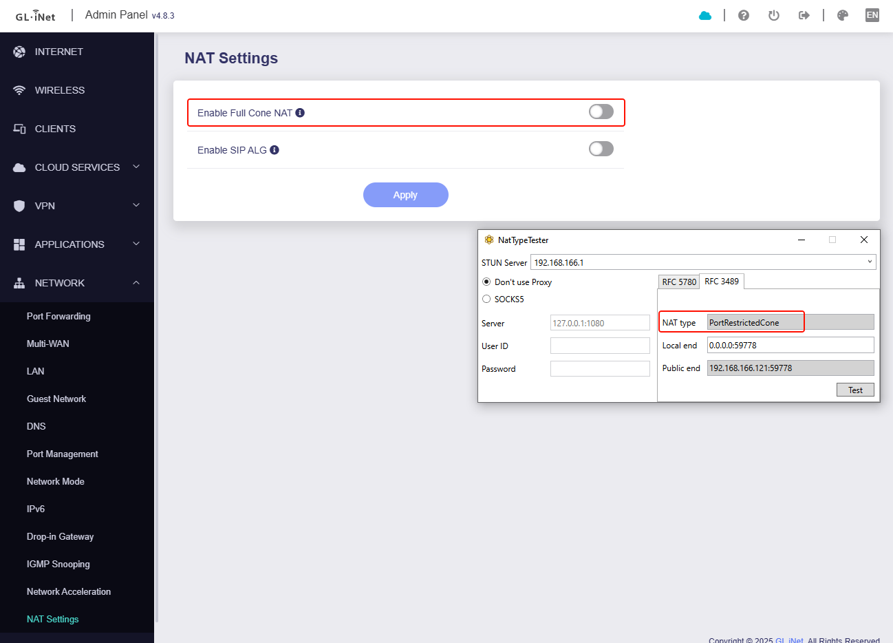

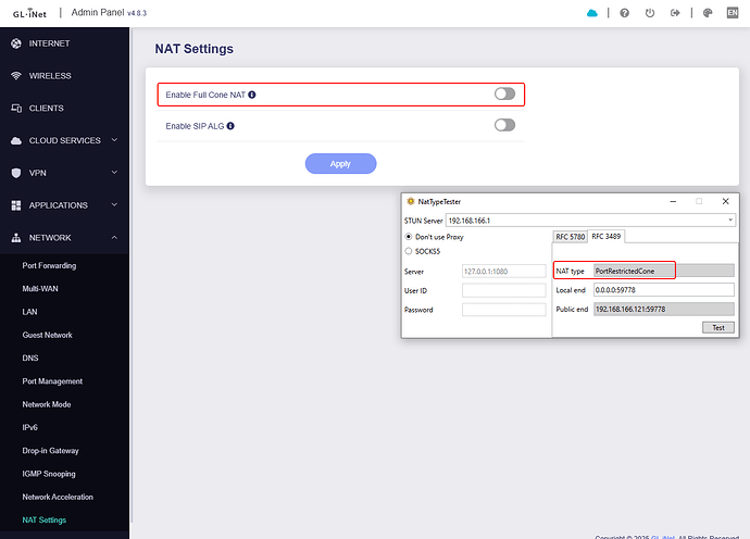

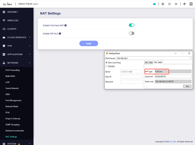

I built a turnserver locally to test the Full cone situation, it depends on coturn, and server IP is 192.168.166.1.
The topology is Turnserver - MT6000 - PC
Test with NATTypeTester, when Full Cone NAT of MT6000 is enabled:
When Full Cone NAT of MT6000 is disabled:
The above test results are in line with expectations, the Full Cone NAT works well.

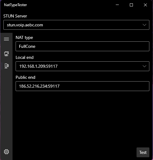

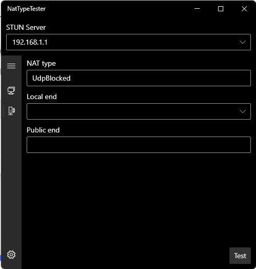

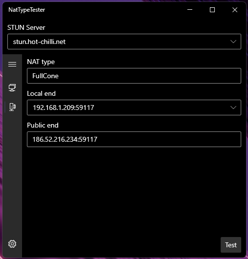

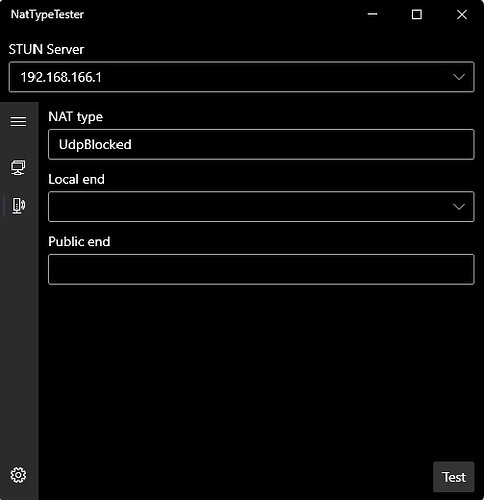

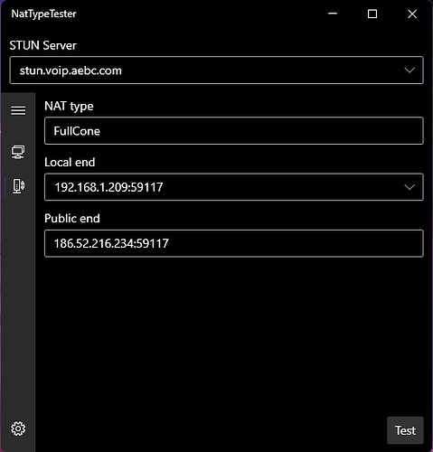

With the other servers it works, but with 192.168.1.1 it still says udpblocked.
The first 2 STUN Server addresses are private addresses, which means you have to build and host a own turnserver on your Flint2 WAN side, only that you can test like my previous reply.
The last 2 are public network turnserver. The test results show that your Flint2's Full Cone NAT has taken effect and is working normally.

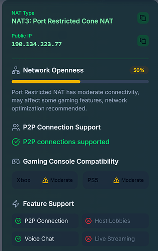

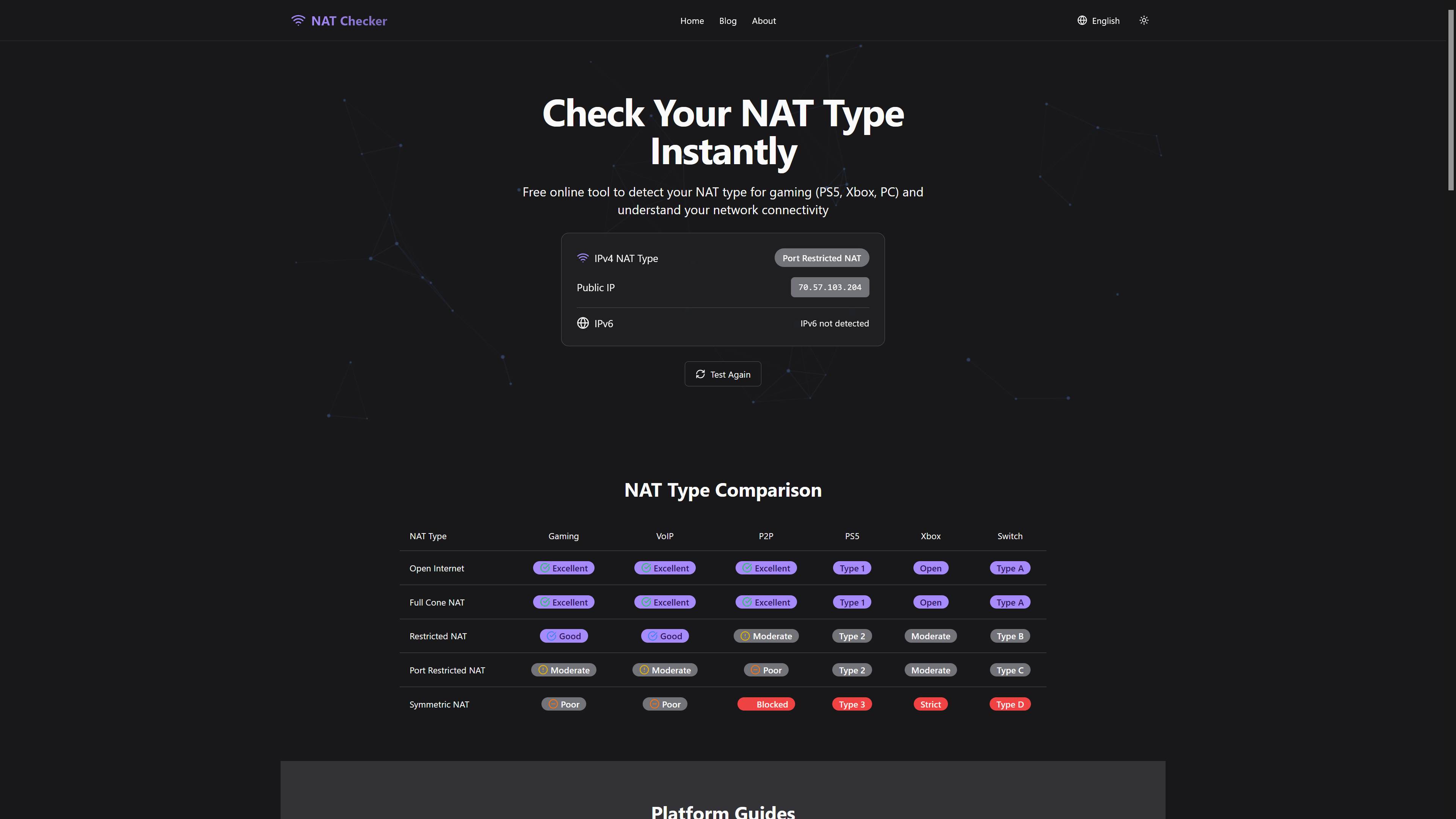

So on my Flint 2 router the full cone NAT is NOT working which is a problem since I am a big gamer. I have it enabled in the router settings yet when I go to test it or play a game I am met with Port Restricted. I am directly connected to my router with my PC using an Ethernet cable and the router is directly connected to the fiber ONT device from my ISP.
Using firmware 4.8.3
What is the test result when your PC is directly connected to the ISP modem (without flint2)?
Thank you for your reply. Here are the results, and may I ask what do you suggest with the Flint 2 router? I can't figure out why it won't allow an open NAT with or without upnp enabled for any of my games or apps.

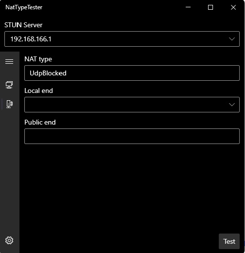

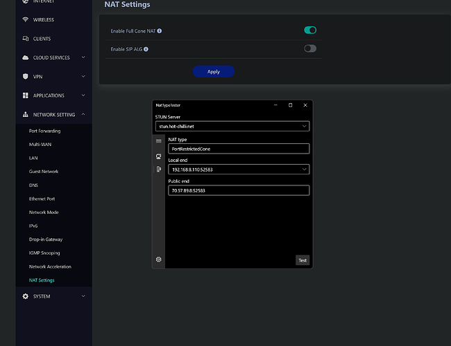

And when connected directly with my PC I get a public address. Hardware acceleration is disabled already and UPnP is installed and running. It appears upnp does open ports for two of my games Call of Duty and Battlefield 6 however it does not for Arc Raiders or NAT testing, VOIP, etc.

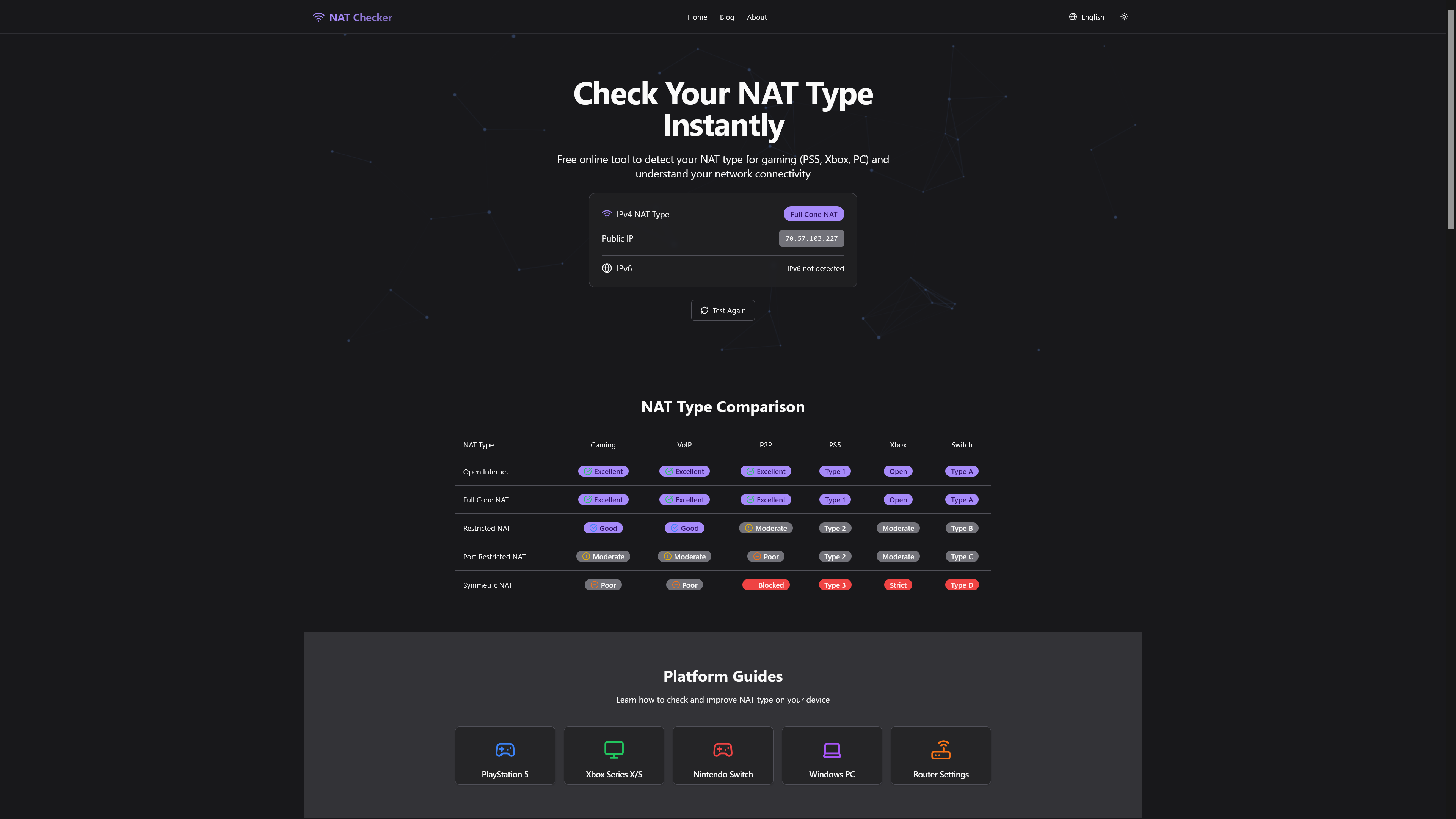

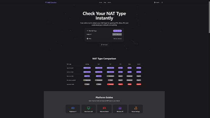

Alright so I confirmed my IP is a public one when directly connected to the ONT device for my fiber internet and that my NAT type is Open when bypassing the Flint 2.

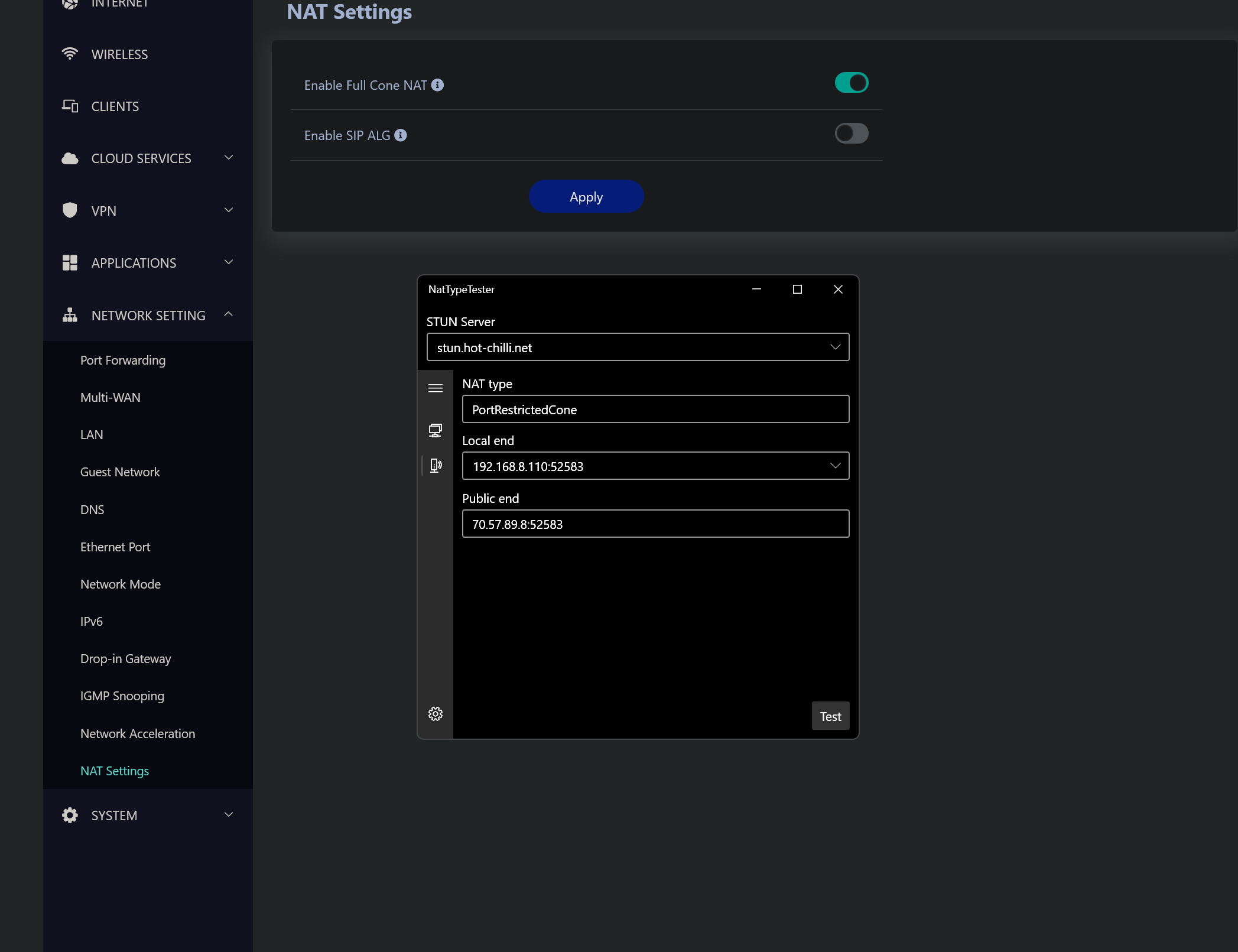

UPnP is installed and enabled. It works for two of my games it appears but not for others such as Arc Raiders or anything else. Here is a screenshot using the NatTypeTester tool.
What else can you suggest? I'm out of ideas at the moment. I have enabled DMZ as a last ditch effort to see if it would work and that DOES allow for fullcone NAT however that is not ideal as it leaves my system wide open without security.

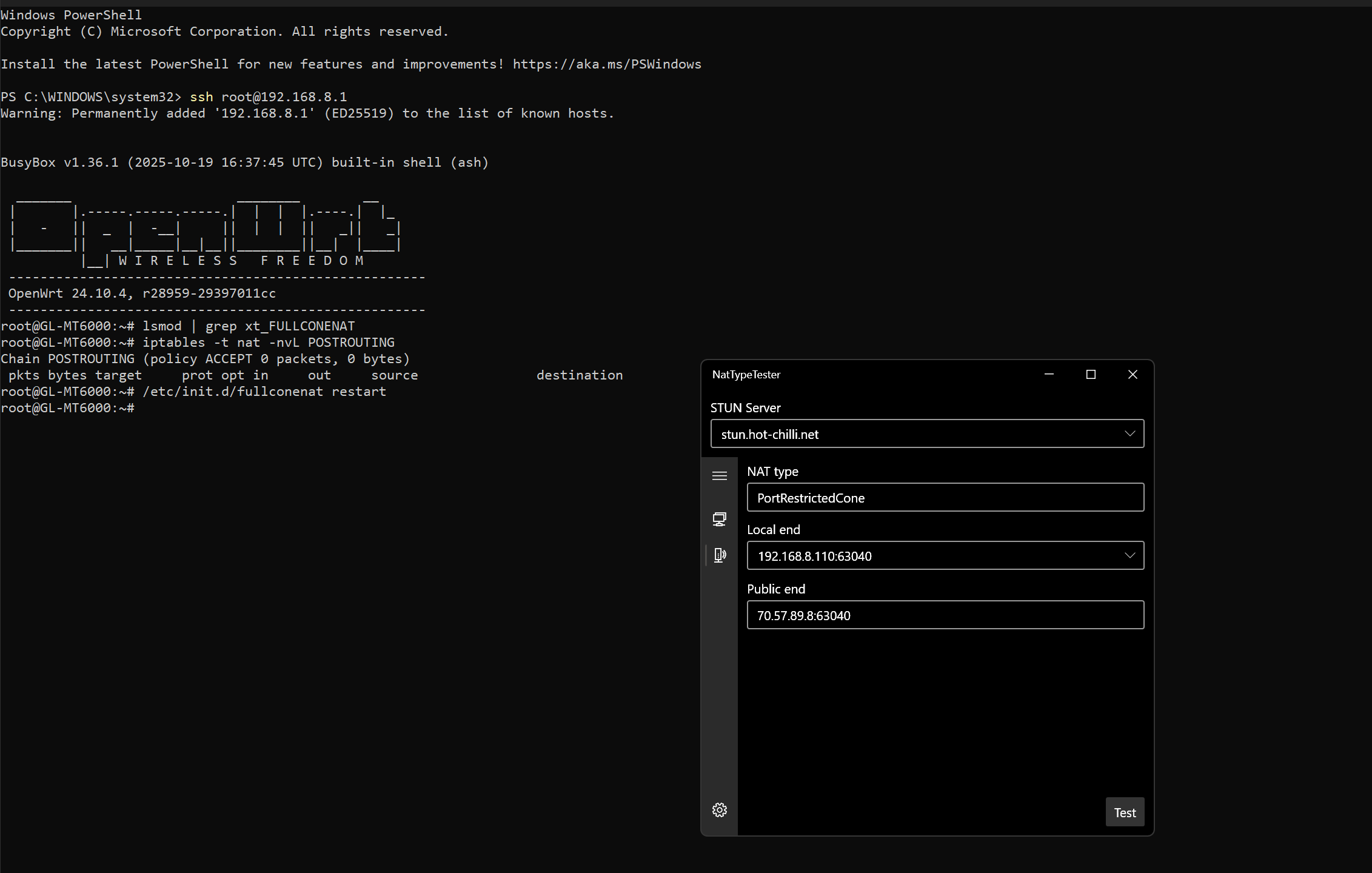

  1. Please SSH to the router and run lsmod | grep xt_FULLCONENAT and iptables -t nat -nvL POSTROUTING to check the output.
  2. Please try restarting the fullconenat service: /etc/init.d/fullconenat restart and try again.
  3. If 2 no luck, please try to reset the firmware and test again.

After inputting the commands via SSH to the router this is what I got..
It appears it didn't work. I should have mentioned I am running the OpenWrt 24 firmware I installed from the firmware list (on this site) provided. I found it to allow more customization and performed in general better than 4.8.3 (aside from this hiccup). I have not installed or changed anything to my knowledge that would affect the NAT type though.
With your test environment and machine there are you able to run the test again using the 4.8.3 OpenWrt 24 firmware? Would using this firmware affect the NAT status without changing anything?
To prevent bots — especially the many advertising ones we've been getting recently, we've tightened account upgrade requirements. We were annoyed by those bots, so.. Now your level has been upgraded, so your reply no longer need to be reviewed.
Ops I just noticed you’re using the op24 firmware in your latest screenshot. I had assumed you were using the closed-source v4.8.3 firmware.
The Full Cone NAT on the GL SDK-op24 firmware doesn’t work properly.
Try disabling the network acceleration and test again.
If no luck, please install the closed-source v4.8.3 firmware, or vanilla OpenWRT firmware.
