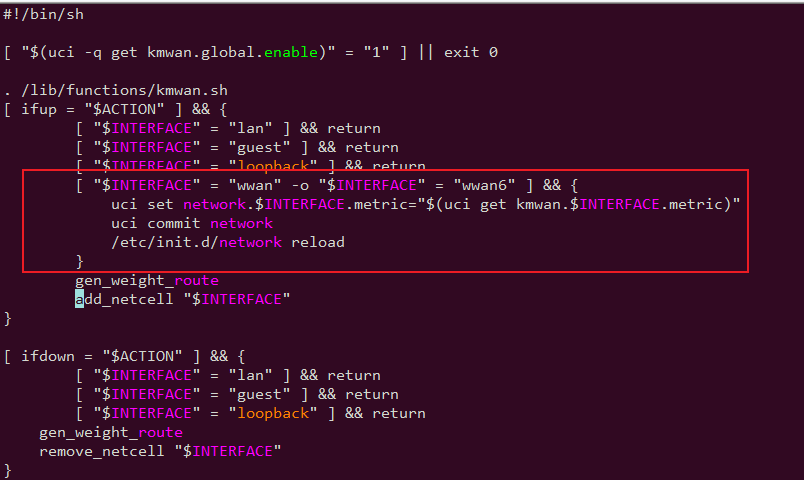

Right now that’s true, you need to set the priority of the relay and Ethernet in advance, and then disconnect all networks from the wan port,To ensure that the priority set takes effect for the trunk, you can add the following to /etc/hotplug.d/iface/99-kmwan before disconnecting the wan port network
[ “$INTERFACE” = “wwan” -o “$INTERFACE” = “wwan6” ] && {
uci set network.$INTERFACE.metric=“$(uci get kmwan.$INTERFACE.metric)”
uci commit network
/etc/init.d/network reload
