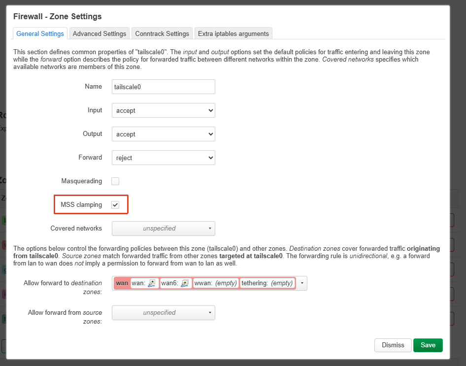

What seems a bit strange is that MSS clamping should already be enabled by default for the tailscale0 zone.
  1. Yes, the setup was using Tailscale subnet routing via an exit node.
  2. Correct, the router sends oversized packets downstream and LAN clients experience eventual SEC_E_DECRYPT_FAILURE.
I can confirm that MSS clamping also appeared to be enabled by default according to LuCI but in the end this turned out to be misleading and unreliable. Turning off GSO/TSO drastically reduced the frequency of TLS connection failures, however it did not completely eliminate the issue. After both having the former workaround in place and enforcing MSS clamping via the iptables rule, I observed no further failures.
