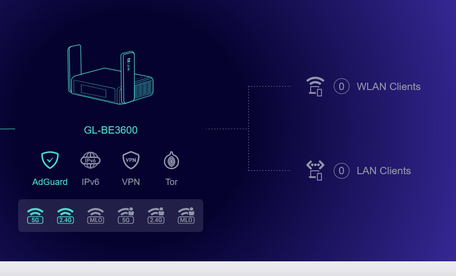

The Bug is as noted in the title. I’ll post a screenshot of the logs my router (Slate 7) is throwing:
As you can see it says I have 0 Clients on this page (it should be 4!!)
Here is the part of the Log that is showing whats happening when I try to load the Clients Page etc.

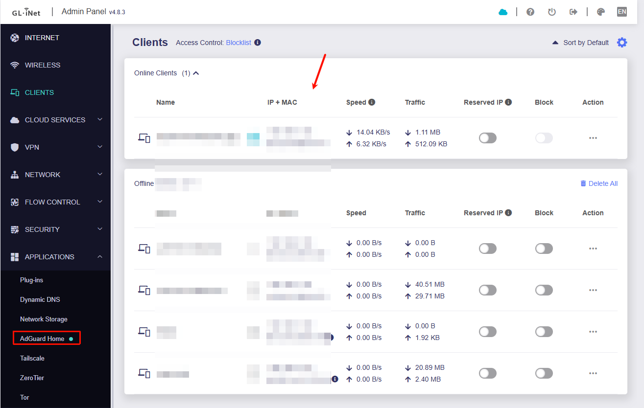

We tested locally using BE3600 with firmware v4.8.3, and after enabling AdGuard Home, the Clients page still works normally.
Could you please follow the guide and share your device with us via GoodCloud so we can check it remotely?
