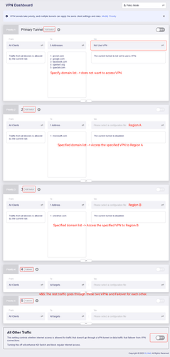

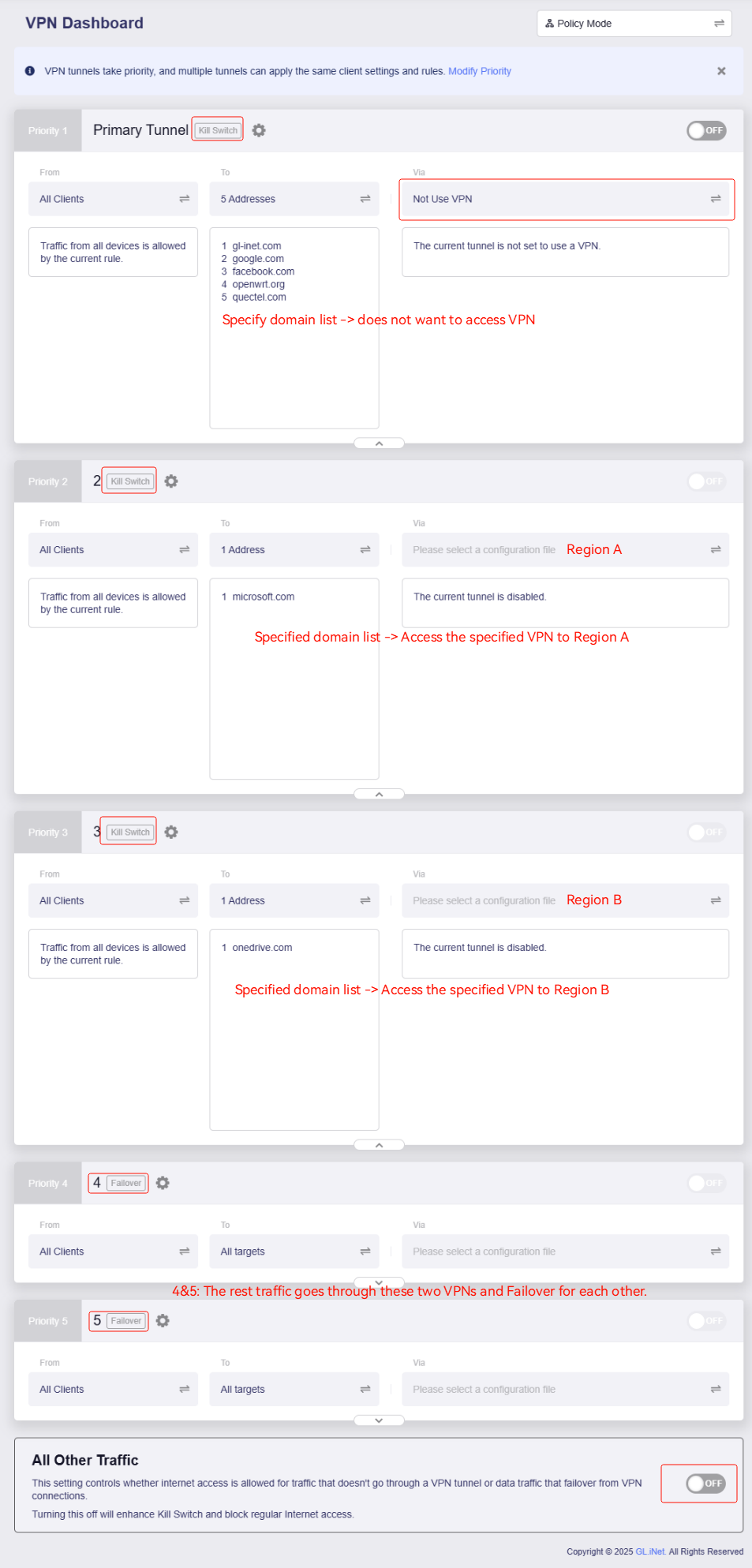

  1. You need to manually specify which specific domain names do not go to VPN (Tunnel 1, Kill Switch)
  2. You need to manually specify which specific domain names to go to Area A, or Area B (Tunnel 2&3, Kill Switch)
  3. Rest traffic, goes to tunnel 4 or 5 (Failover. If you need failover to next tunnel, just disable the kill switch, and will switch to failover.)
  4. Since there are VPN tunnels 4 and 5 for all rest traffic, so it is not allowed to go to WAN (Disable All other traffic)
According to your actual needs to customize configure the tunnel configuration, but supported up to 5 tunnels at present.
