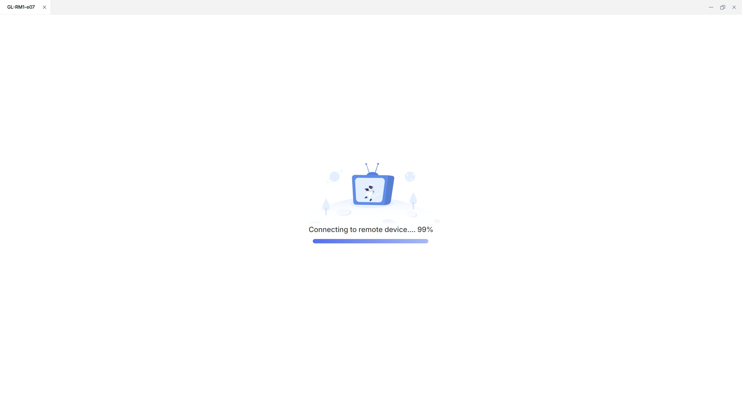

Since 2 days i’m not able to connect to my KVM using Windows app (i guess via cloud) but i’m able to connect directly from browser.
I’m facing below’s screen in app.

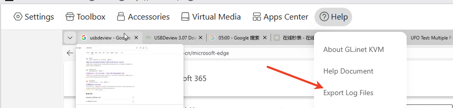

please provide log of device
Yea, there was another bug - i was not able to export logs, that’s why i provided them manually.
There was no reaction, nothing after click Export Log Files. Just after some another reboot of device it started working and i was also able to connect, but transmission was so lagged that it was still useless.
However, i’ve attached logs which were finally possible to export.

We will optimize the issue of connection errors and inability to export logs in the latest version

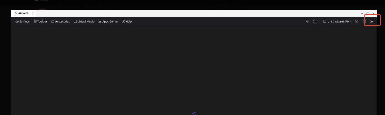

And.. Today i have problems again.

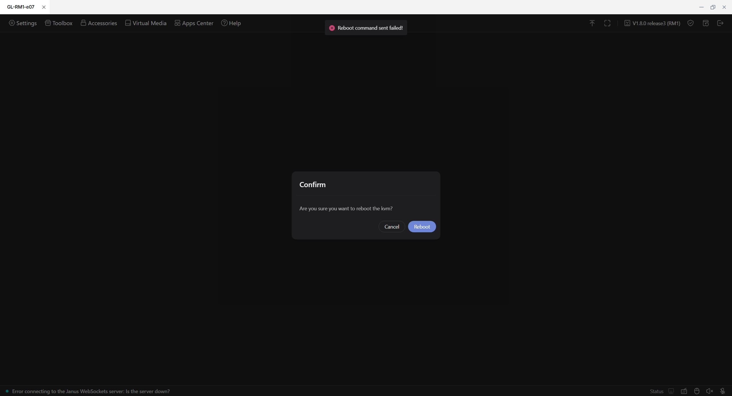

Firstly i was unable to connect like mentioned earlier (black screen). Tried export logs which opened window to save logs file (but single log.json, not zip file) but it seems it didn’t save that file (definitely not in choosen folder). Then i tried reboot from app which results with error:

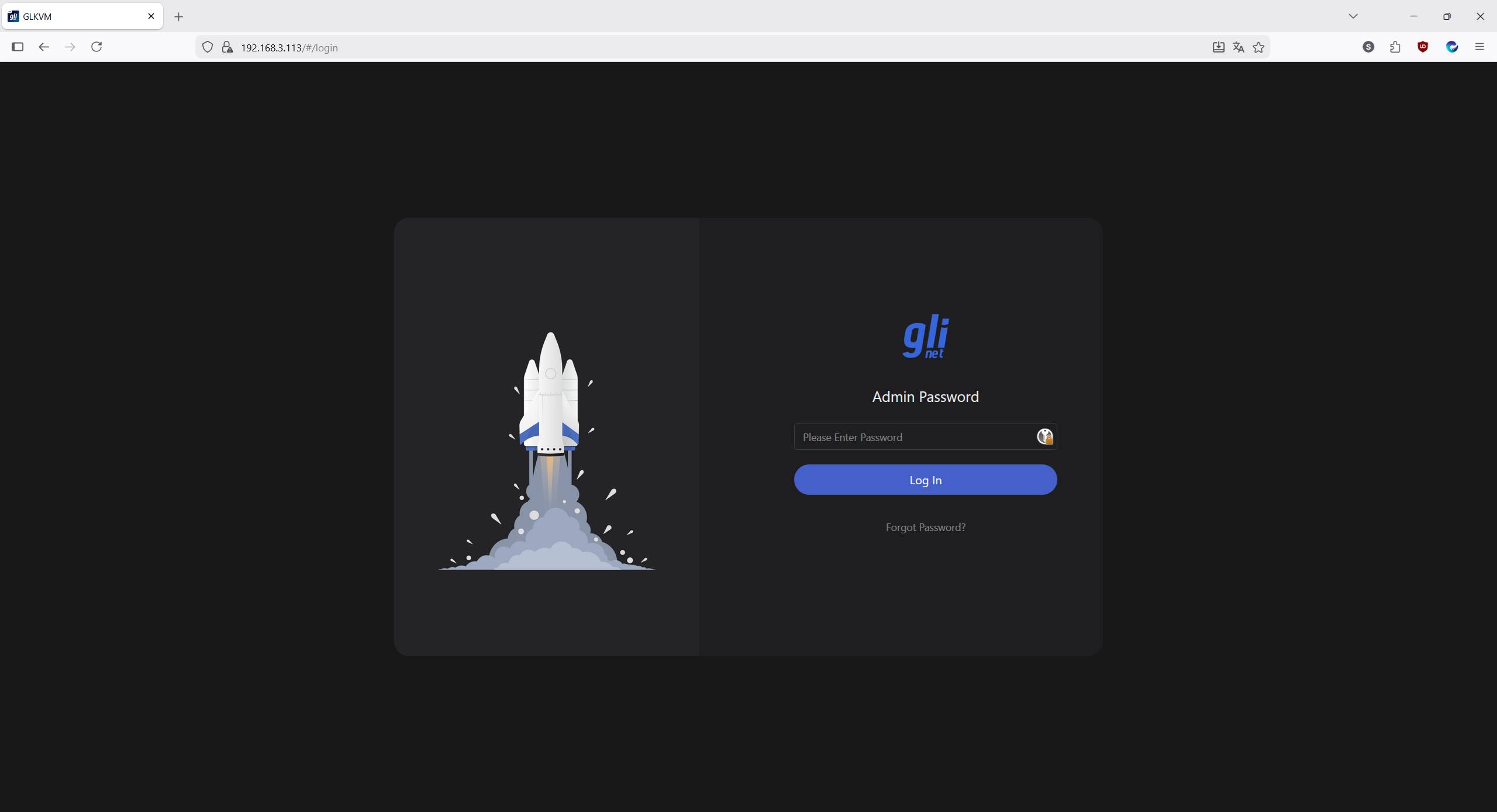

So i run reboot using browser and after boot i was able to connect using browser:

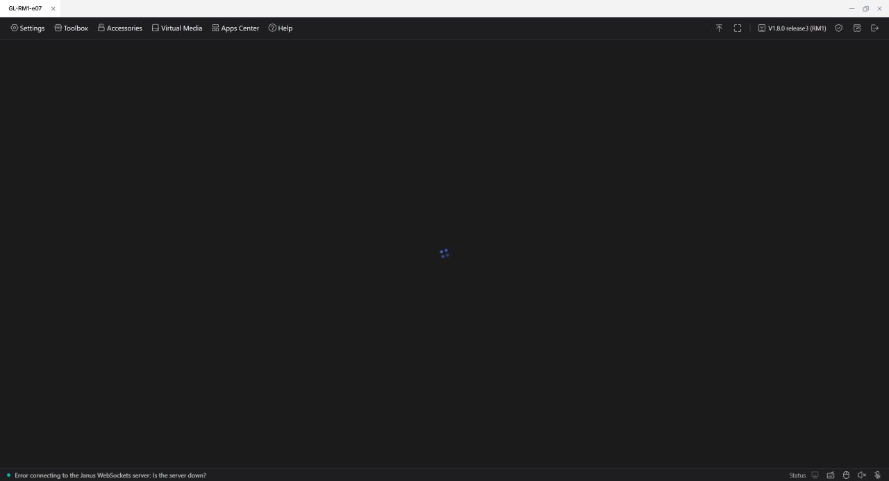

But not using app. It stuck on 99% for longer time

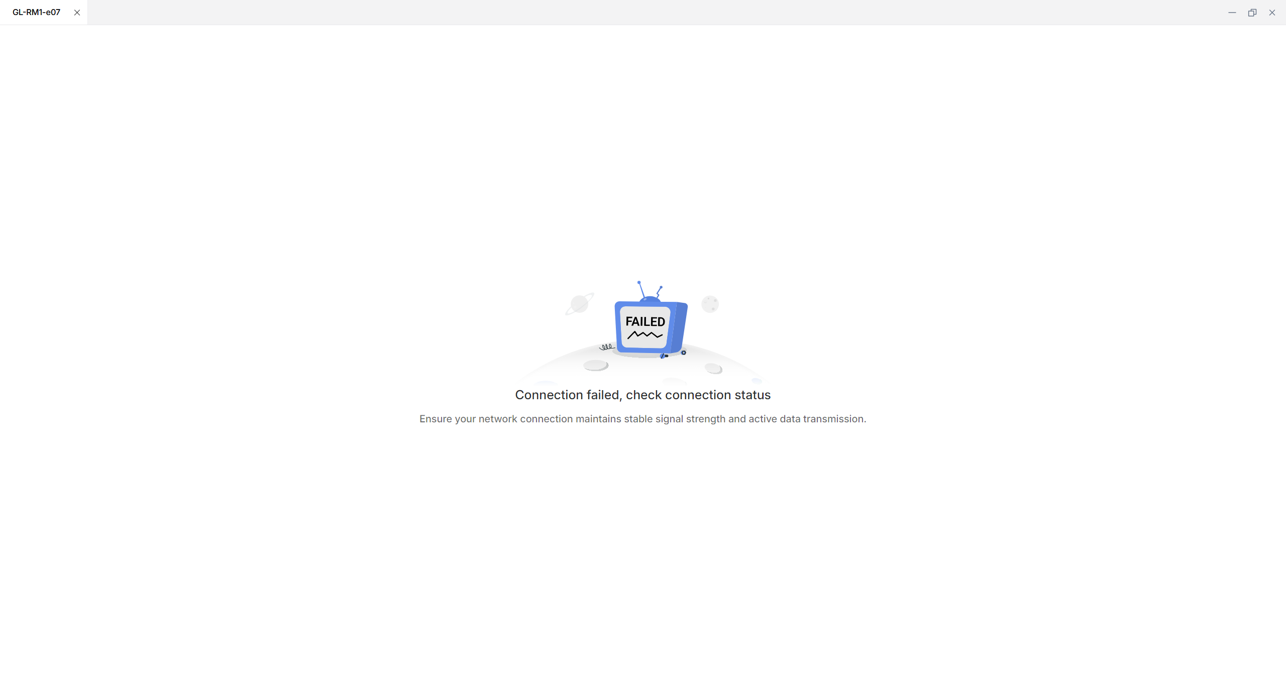

and finally displayed connection error:
I wish it could be so easy… Of course i tried re-log in, but unfortunately with no luck.
