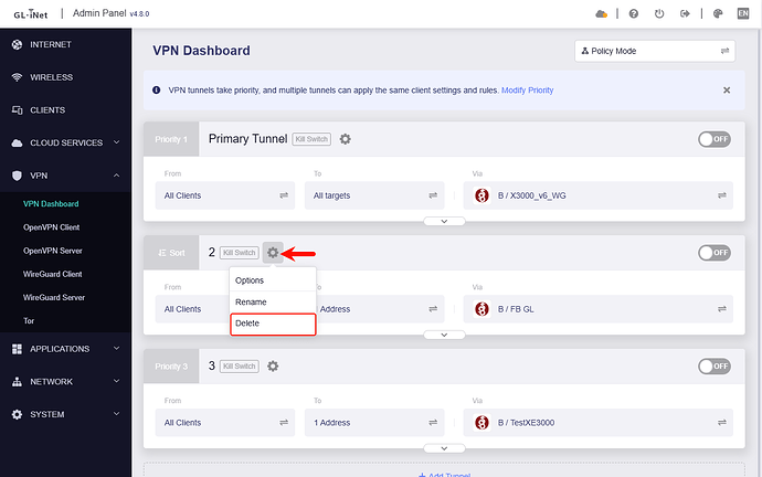

Please delete the other tunnels here until only one:
If it cannot be deleted, please provide the screenshot, and whether there is any error, etc.

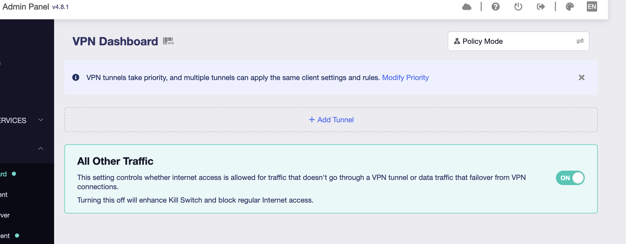

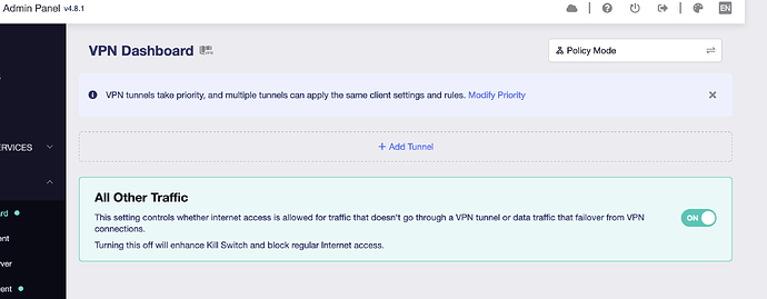

thatts the issue - i cannot replicate ur screenshot. as u can see from the photo, when i click into vpn dash, this is all i see.
[as a new user i can only post one image in a comment at a time, so i have to make multiple comments]
i click the book icon next to ‘vpn dashboard’and i am unable to click continue, despite there being 3 vpn tunnels currently.

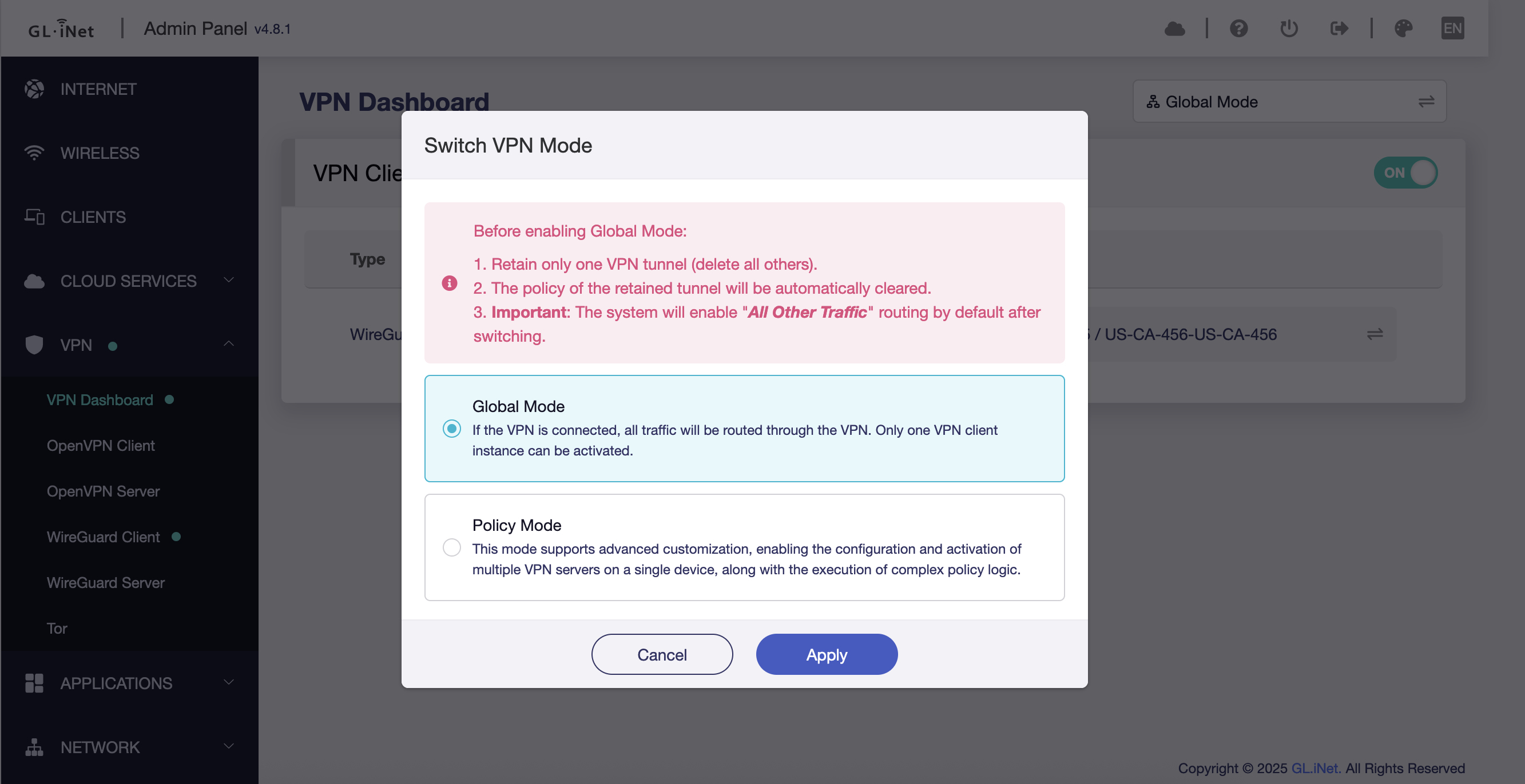

i try to clickinto global mode and below is the error i get

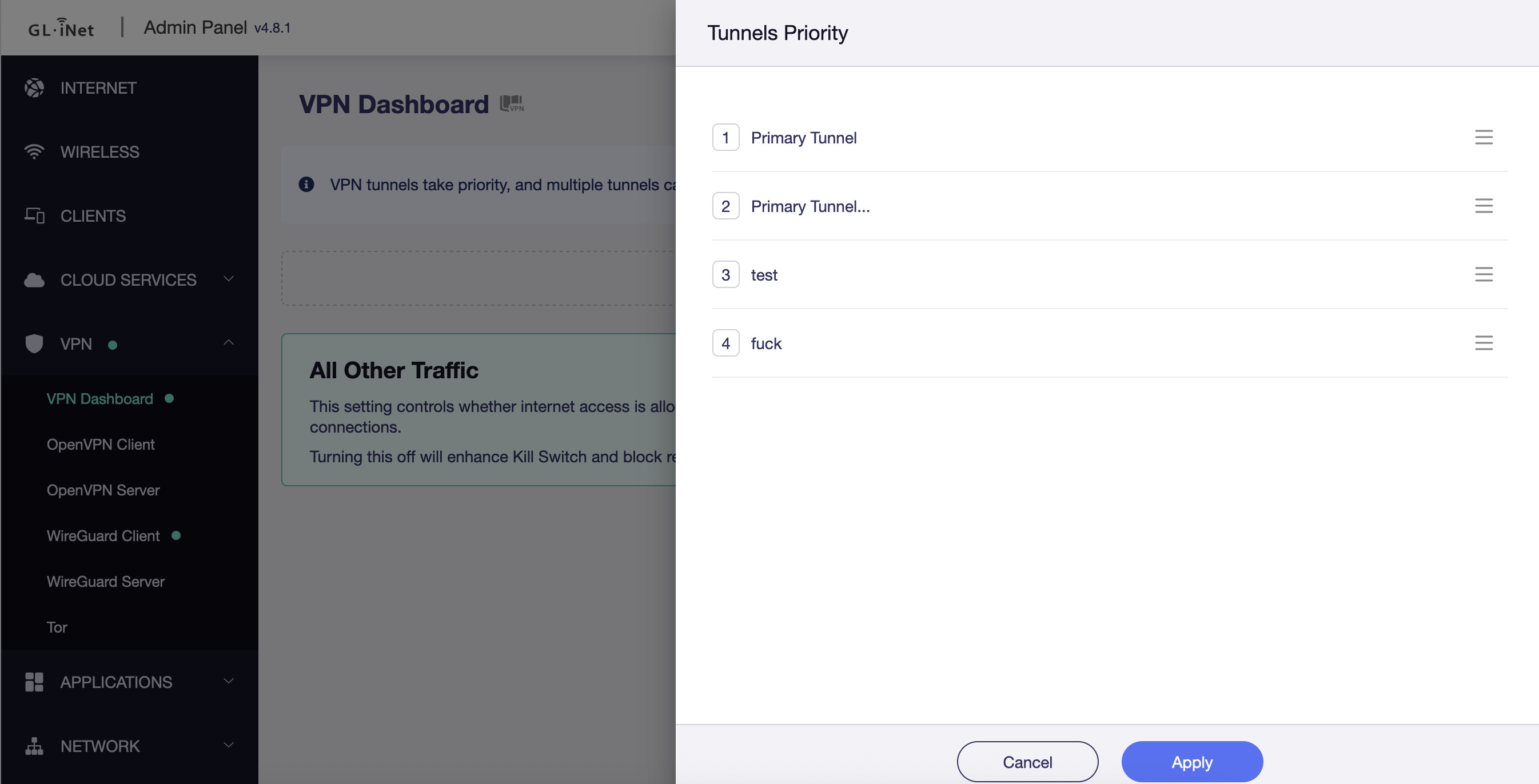

most importantly, underneath the ‘vpn dashboard’ header ont he vpn page, there is a sentence “VPN tunnels take priority, and multiple tunnels can apply the same client settings and rules. Modify Priority” i then click modify priority and this is what i see:
as u can see there are 4 tunnels. yet they are not represented on the ‘Policy mode’ page
i have not seen this topic discussed in the forum. i do not see a way to delete the vpn tunnels. i do not see a way to configure the vpn tunnels even when policy mode is enabled
Actually, I see there are currently 4 tunnels, but they are not displayed on the Dashboard. Bit strange.
