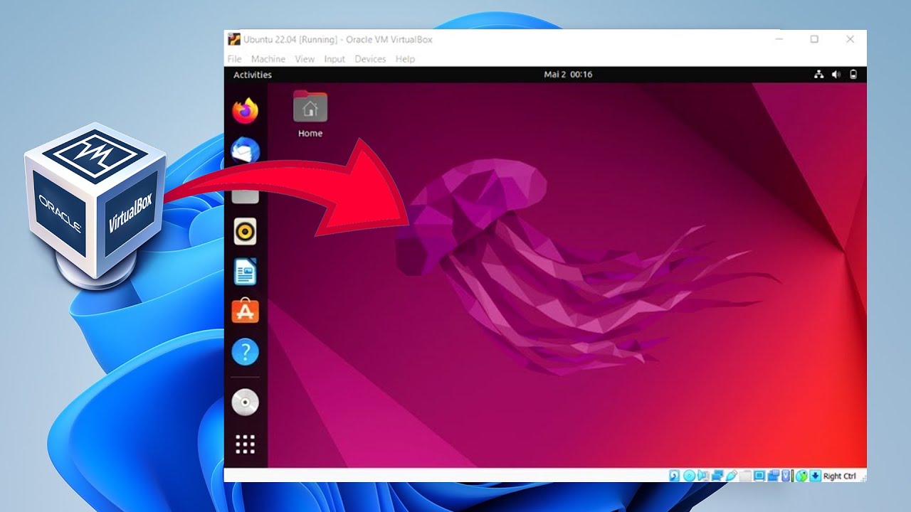

This is me being off topic but at some point do consider installing Virtualbox on your computer. You can then run a copy of whatever Linux distro you prefer in a ‘petri dish’ & experiment to your heart’s content.
If something ‘goes sideways’, the snapshot feature allows 'ya to revert in a couple of mouse clicks.
https://www.virtualbox.org/wiki/Linux_Downloads
