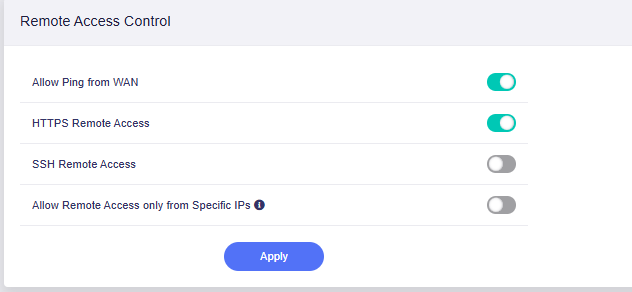

When doing these operations, are you connected to Beryl's WiFi or your home main WiFi?
You can enable MT3000's WAN port access rights. At least it should be able to access the IP address assigned to it by the upper router.
Thanks for your reply. The only connection method that worked for me was via cable, until I enabled the two settings you point out. A reboot later, I can finally connect via home wifi, and set up this router, for use on the road, eventually. Am in business now.
