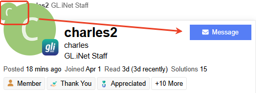

Please share the command outputs with us. If possible, please also export the system log after reproducing the issue; you may send the system log to us via private message.
