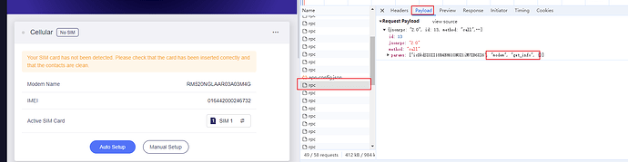

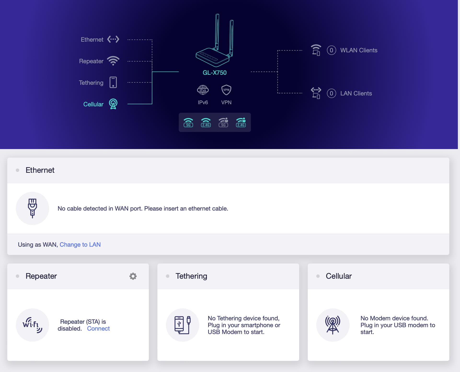

After a while of running smoothly, I logged into the interface of my GL-X750 and saw that cellular is active, but at the same time, the interface doesn't see the modem.... but there is an internet connection through cellular.
I wanted to modify the configuration, but the interface just won't let me because the tile is greyed out. See the screenshot. Anyone with the same problem?

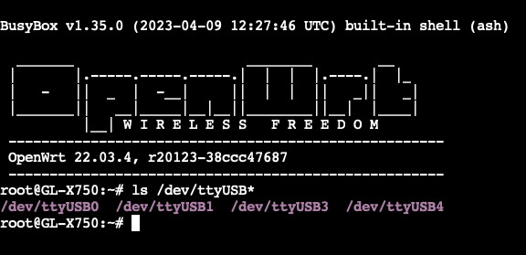

Can you ssh into the background of the router?
ssh root@192.168.8.1
ls /dev/ttyUSB*
I did, see screenshot attached

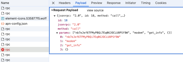

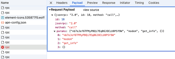

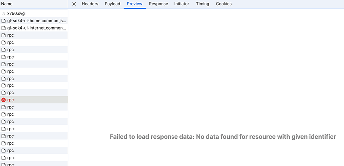

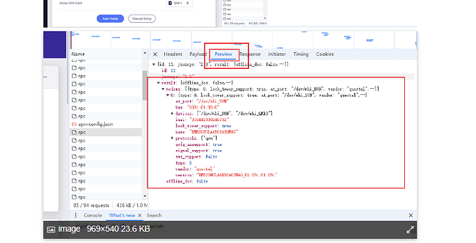

Can you find this api and show me a screenshot of the preview page

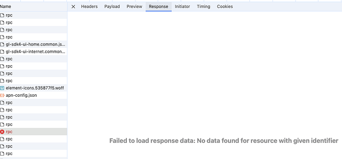

Found the faulty API call, despite of earlier statement that there are no failed API calls, sorry.
Please see the screenshot:
HTTP response code is: (canceled).
emm, does this page return anything?
Has the module been replaced?

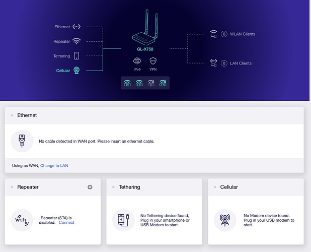

The preview pane is empty and is expected since the rpc call failed (canceled) so it doesn't return anything. The module isn't replaced, it's just a working router which had a functional interface for the modem, but it vanished from the GUI in some unclear way:

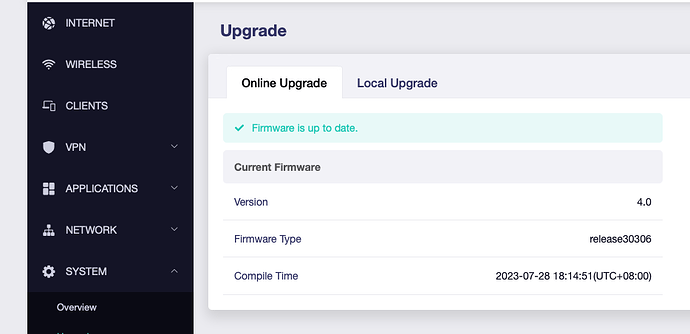

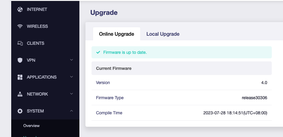

Upgrade the firmware?
I don't have replications locally
That's also one of the things I thought about to move forward, but the device tells me that it's already at the latest firmware.
https://dl.gl-inet.com/router/x750/
Upgrade it manually
It's now 4.3.17

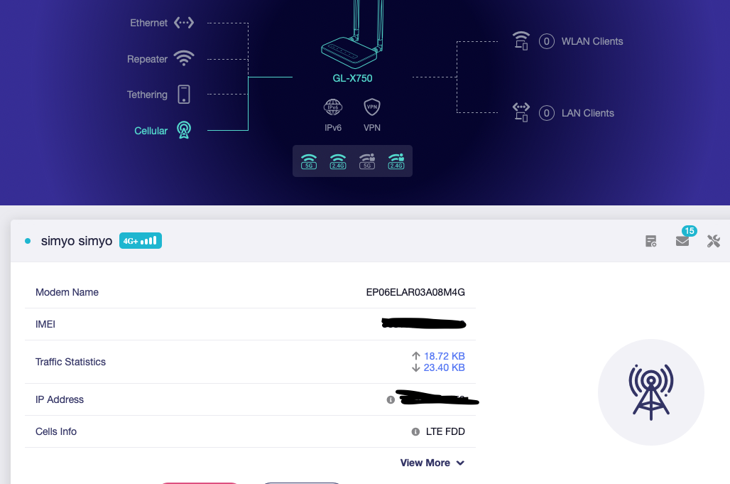

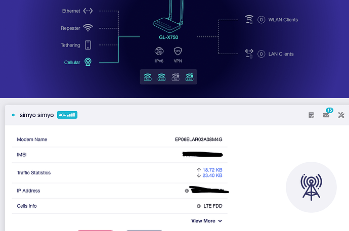

After doing to upgrade to the 4.3.17 version, the Cellular interface tile appeared again! Thank you for your suggestion! But why does the interface tells me that the firmware is up to date while it isn't ?
