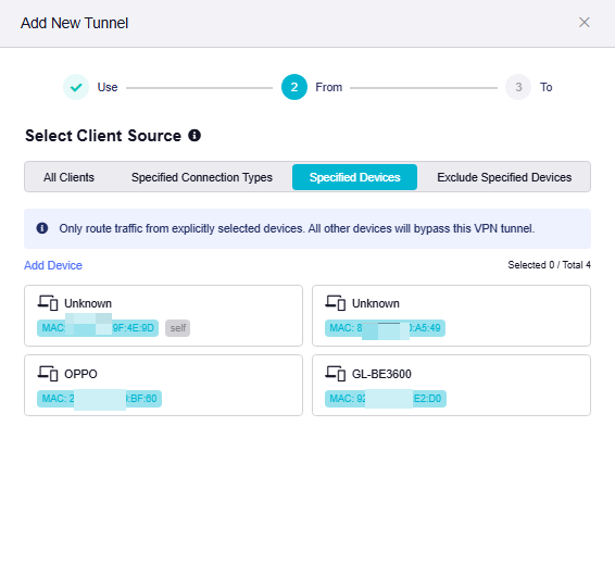

Since I'm using policy-based routing with VPNs, I find that not reserving an IP can cause problems as the device being rebooted will have a new IP and then won't connect to the right VPN. In terms of privacy and security, are there any consequences from reserving an IP? In which instance should reserving an IP be disabled?

Policy based routing should be using the MAC instead of IP (as this does change). Can you describe how you are setting up your routing?

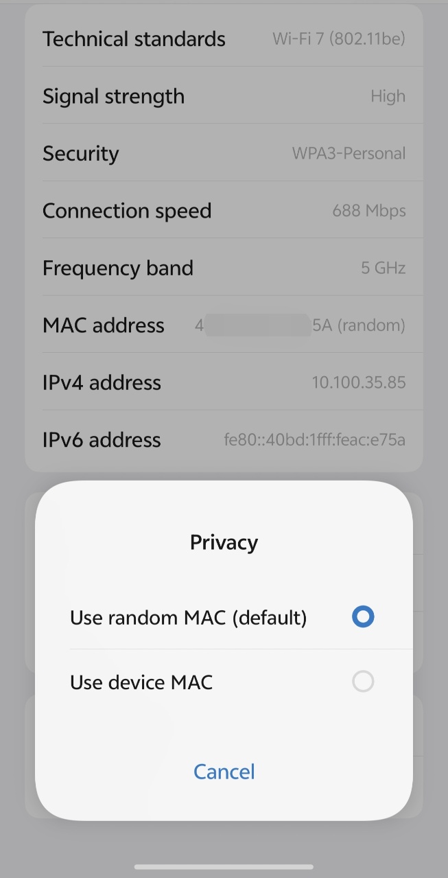

Could be that the devices you are using a randomised mac address for privacy, which is why they stop working as the device rotates to a random mac address after a period. perhaps change the device to use the factory MAC.
How do you do that? In the GUI, I can only select the device.
How do I do that?
You need to check the wifi connection settings on the devices themselves. So if it’s your phone, make sure the wifi connection settings aren’t set to randomise MAC
Either turn randomisation off or fixed.
I'm reading that it protects my privacy. Any other way to make it easy to ID my devices?
None, that’s the way it works. If there was a way to id them then it wouldn’t be very private.
For the VPN policy, when Specified Devices is selected in the current VPN Dashboard, the devices are identified by their MAC addresses

This setting usually needs to be changed on the client device rather than in the router GUI.
For example, on my phone, open the Wi-Fi settings for this network and change the MAC address type from a randomized/private MAC address to the device or factory MAC address.
