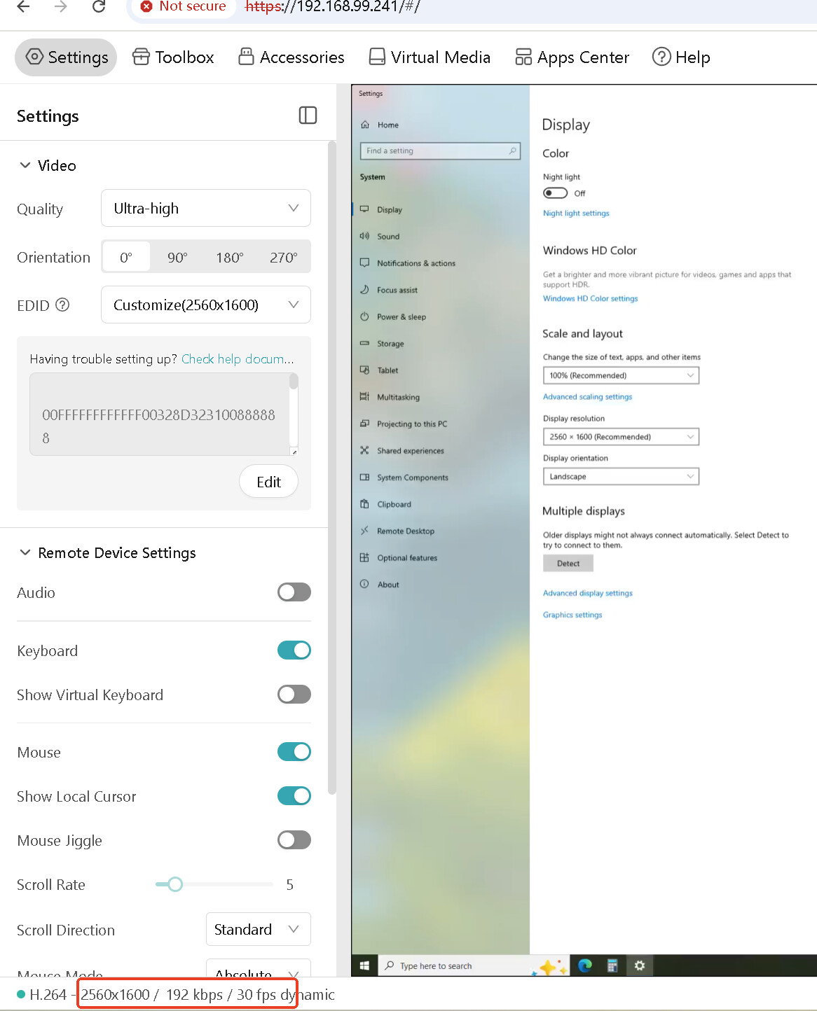

I'm unsure how to make an EDID. Could someone who's familiar help me out with one for 2560 x 1600? I believe 30hz will be the max.
THANKS!

pls try this
00FFFFFFFFFFFF00328D323100888888
201E0103800C07780A0DC9A057479827
12484C00000001010101010101010101
010101010101A93300A0A04017603020
36000040A600001E023A801871382D40
582C4500C48E2100001E000000FD0018
6414961E000A202020202020000000FC
00415355530A2020202020202020017D
02031DF04A0104101F2021225D5E5F23
0904018301000065030C001000000000
00000000000000000000000000000000
000000000000000000000000000000BA
