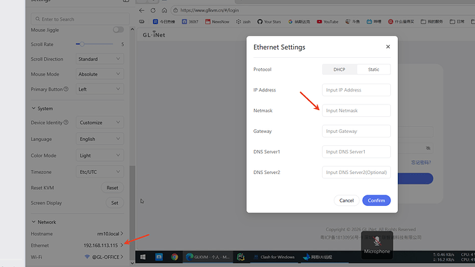

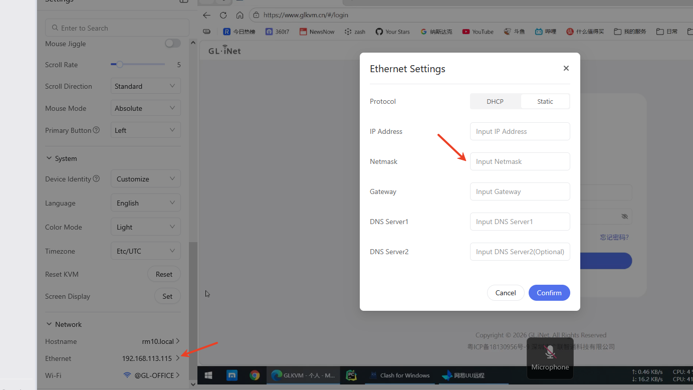

Configure a static IP on the page. It seems that ninety percent of users no longer experience issues after setting up a static IP.

If you are talking about KVM keep blink led, and cannot access even from local area network. I still suggest you to upgrade to 1.9.0, I tried to add some patch to fix this problem in 1.9.0. Many user mentioned that they fix it by setting a static IP address on KVM
