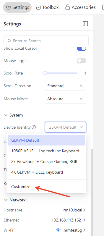

Could you SSH in and then delete all your changes to override.yml?

If you ever modify USB identify settings on the website, you should remove content of `/etc/kvmd/user/boot.yaml`, or it will finnally be override.

Of course not, it only changes the underlying actual effects. If you want it to alter the display on the page, you should place it in boot.yaml.
