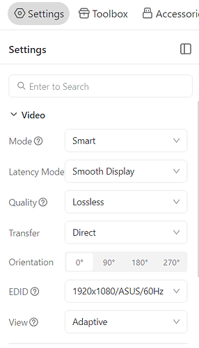

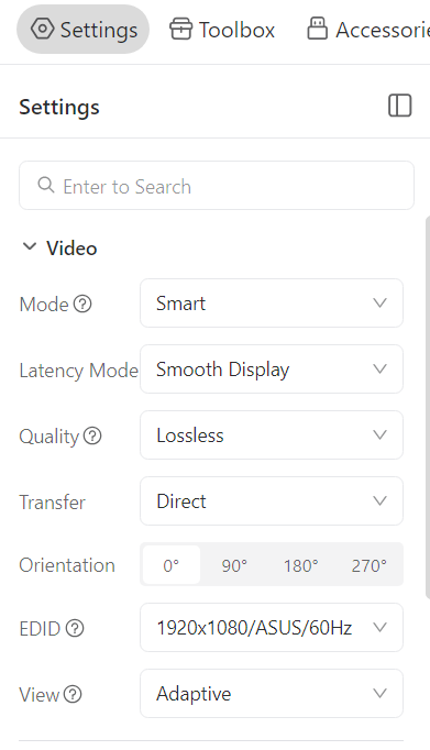

According to the logs, the black screen issue is caused by network problems, specifically frame drops. Are you accessing the site on a local area network or via the internet?
which mode you using? Direct ? try webrtc(fec)
I use LAN only.

Tried Both Direct and WebRTC, now as I said it works, but when I got the black screen, didn’t work at all.

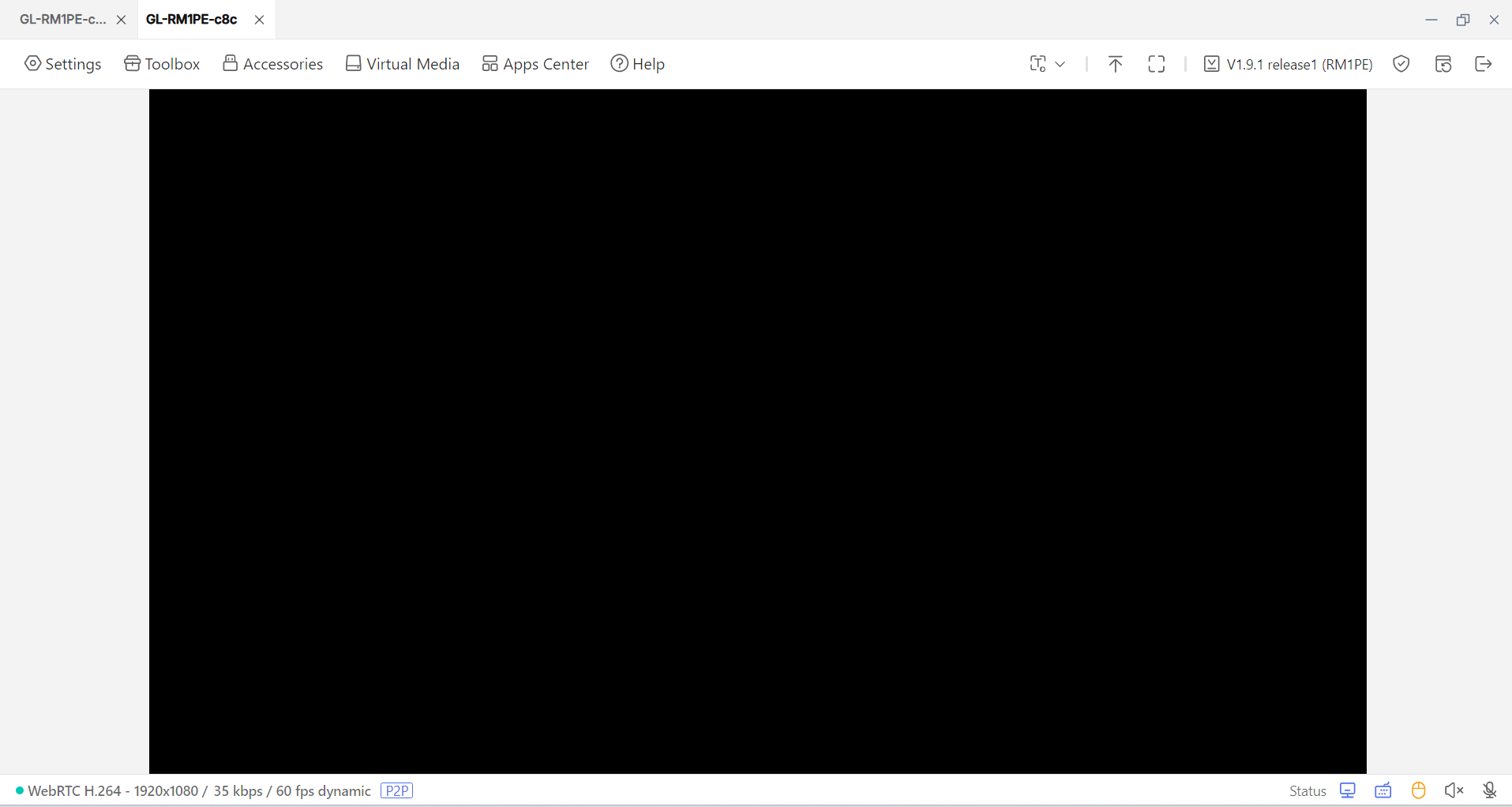

Can you take a screenshot of the black screen? The full one including the bitrate and frame rate bar at the bottom.
This looks like an issue with the HDCP key, but if there were a problem, it should have been persistent all along. Please run this command and give us the results.

In that case, it can only be an issue with your controlled computer, because all evidence shows that the video output from your controlled computer is a black screen. Since it is outputting a black screen, the KVM can only display a black screen for you.
Generally speaking, this is an HDCP key issue, or at least your graphics card considers the HDCP key to be problematic. However, based on the command detection results, the HDCP KEY should be fine. You might consider looking for a way to disable the graphics card's forced HDCP key verification.
the typical symptom of an HDCP issue is that the picture appears for the first two seconds, and then the screen remains completely black afterwards.
