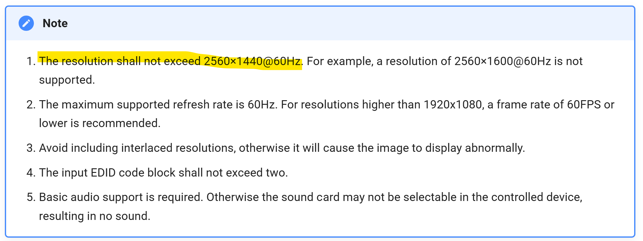

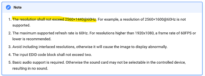

The marketing/advertising says that it can do 4k at 30fps, but online docs conflict, saying it’s not possible to go above 2560 x 1440 (see screenshot below). Is there anything that can be done so I can get the benefit of the full resolution without messing up the mouse movement or is the only option to turn down the resolution on the laptop?
Under the condition of not exceeding 2560x1440 @ 60Hz, the frequency of 2880x1800 should not exceed 42Hz. Here is a 2880x1800 40Hz EDID that I have verified is available.Buddy, you can give it a try.
