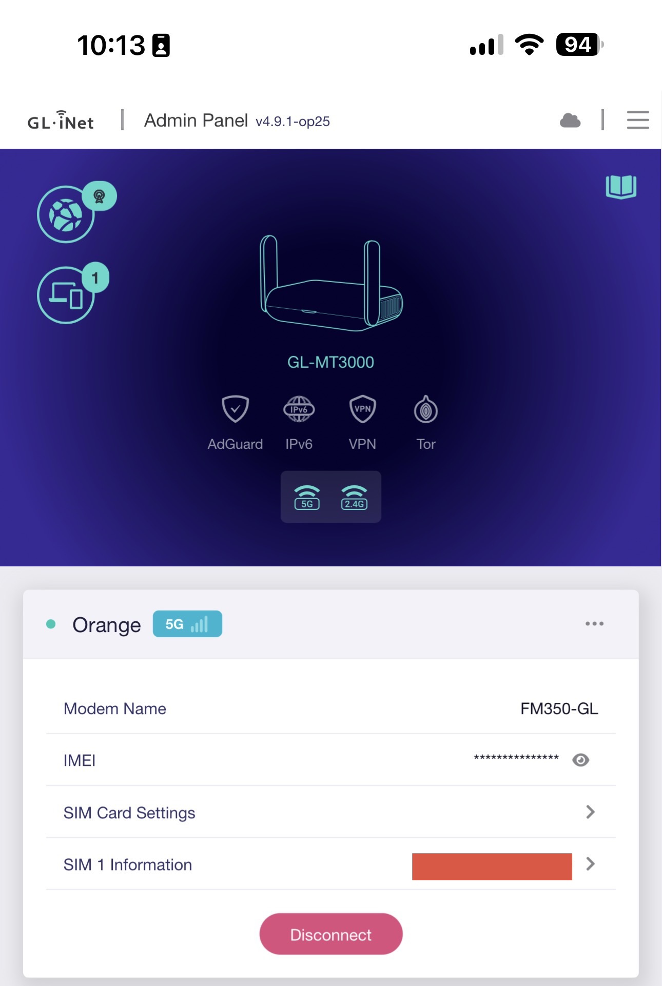

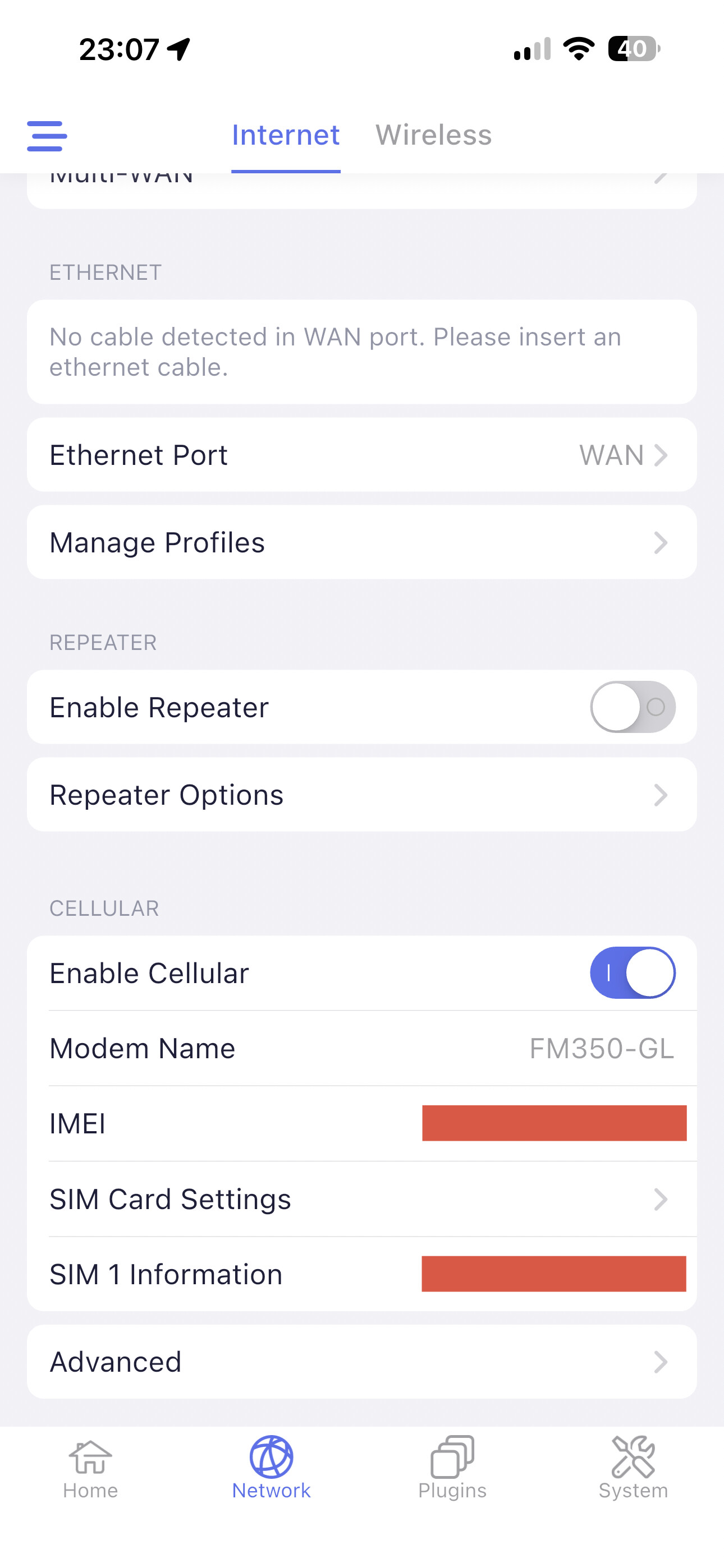

On my reference setup, I have confirmed:
• Detection by GL.iNet’s stock cellular services
• Detection in the GL.iNet admin panel and mobile app
• SIM status
• ICCID and IMSI retrieval
• Runtime addition of the FM350 model definition
• Restoration of the original stock paths when the package is stopped or removed
