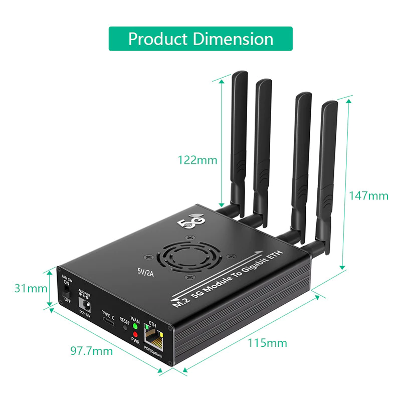

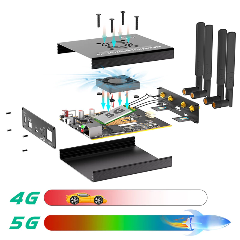

Hi. I’m planning to use a Quectel RM520N-GL 5G module connected via USB adapter (like the one in the picture below).
Will the new GL.iNet Slate 7 router recognize it and provide internet access (main or backup) through the USB port?
I know Slate 7 supports USB tethering and some LTE modems, but I’m not sure about 5G modules like RM520N-GL (Sub-6 GHz, PCIe/USB 3.1).
Does the firmware include the required drivers, or would it need custom configuration (e.g., qmi, mbim, or rndis mode)?
Thanks in advance!
The RM520N-GL is listed in the compatibility list, so it should work directly.
Cellular - GL.iNet Router Docs 4
This USB adapter also appears to provide an Ethernet interface, which should allowing you to connect directly via the WAN port of Slate 7 instead of using the USB connection.
