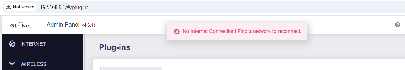

Hi, I have Slate AX and a Cannon MF4730. The printer works through usb. But cannot figure out the scanner. Does your solution work for me also?
May you can try to install this plugin airsane or cups in Slate AX to test.

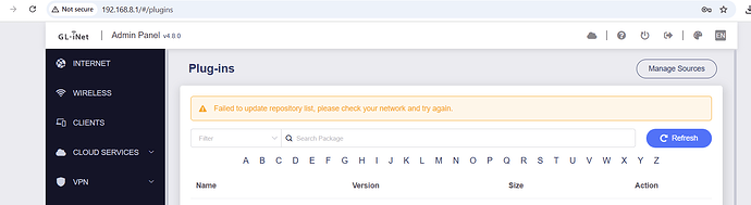

Hi, thank you for replying. Cannot install any plugin. I get an error, no internet when I select plugins.
The Slate AX latest firmware is v4.8.0, please upgrade the firmware first, since this version (later) is better compatibility for plugins.

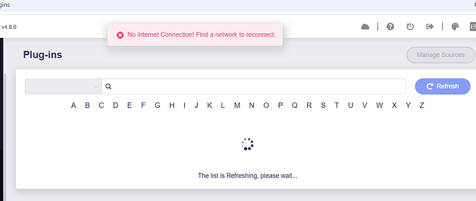

Hi, thanks for replying.
Same error

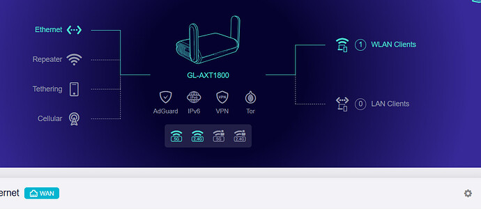

Should mention that I am behind another router.

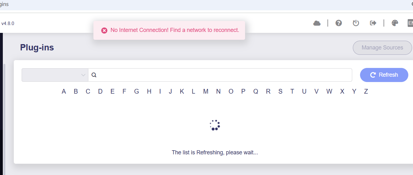

Please SSH to the router: opkg update
If no luck, please check these
ping fw.gl-inet.com
wget https://fw.gl-inet.com/releases/v23.05-SNAPSHOT/packages-5.0/aarch64_cortex-a53_neon-vfpv4/packages/Packages.gz
It seems to be able to connect to the GL opkg repo.

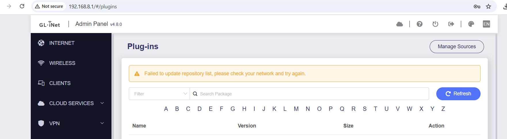

Please SSH to router and try:
opkg update
The update worked but still no internet.

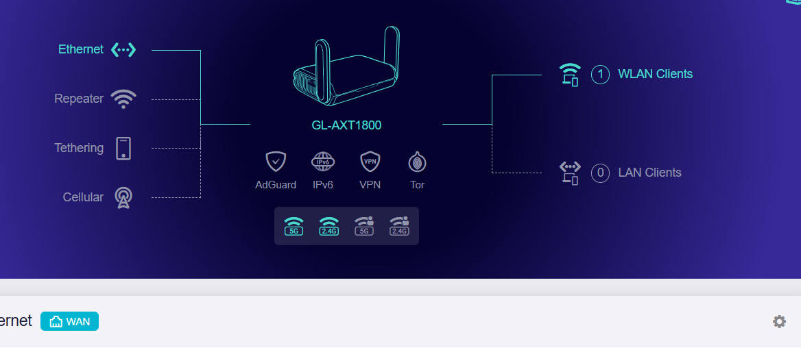

Please let me know what router model is the primary router?
  1. You can change the WAN, such as directly connecting to modem or repeat your phone hotspot
  2. Please upgrade to the latest firmware, like v4.8.0-beta9.
