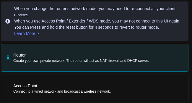

I have an Ethernet device (it’s a PLC, but it could be a camera or anything else) we will call it 192.168.8.2
I have the gl-ar750s we will call it 192.168.8.1
I want to be able to log onto my computer and communicate directly with address 192.168.8.2 over WiFi.
I have updated the firmware to 4.3.25
I can plug the computer & the device with cables and ping both the gl-ar750 & the device.
I can’t make it work over WiFi At all
I am setting as an LAN.
I don’t know if it should be an “Access Point” because it’s not a network, it’s a device.
Any advice on how to do what i want with the pieces I have?
192.168.8.0/24 is the default subnet (LAN) if set as 'Router' including over Wi-Fi.

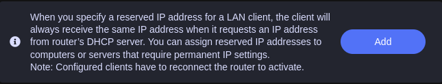

That would be best done with a static IP/DHCP reservation so the client device doesn't change its IP if reconnecting some time in the future. GL GUI -> Network -> LAN -> Private Network:
