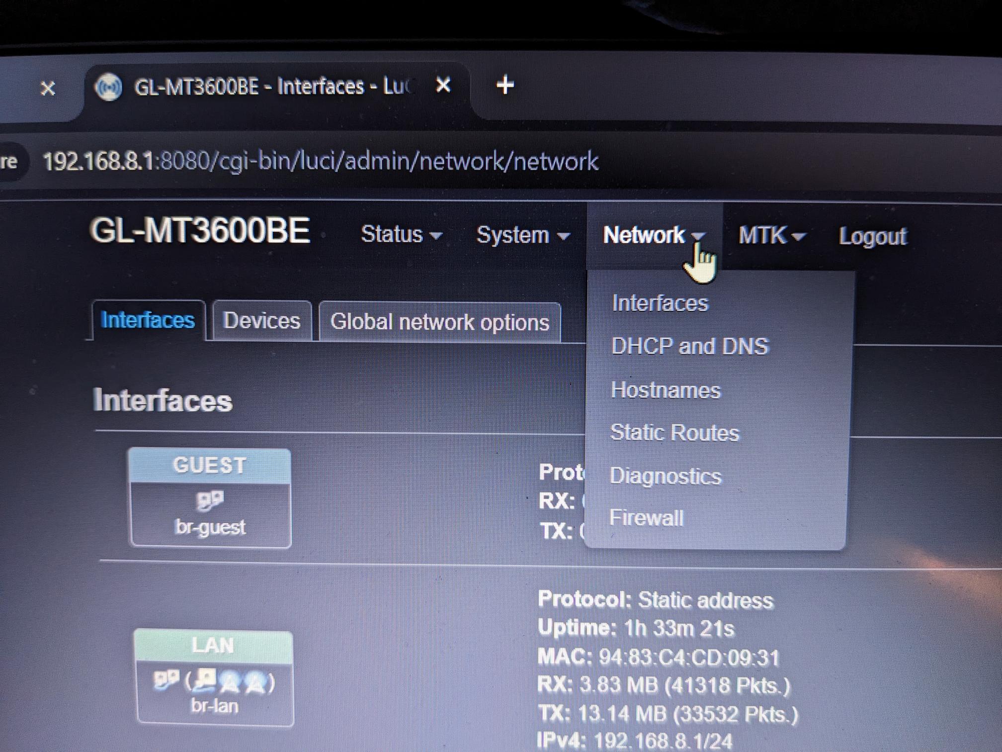

Thanks for the help, Bruce. I followed the instructions and went into Luci, but unfortunately there is no option for Wireless under the Network tab. I didn’t see any Wireless/EAP options under the other menus either.
Sorry, the Beryl 7 does not have a standard wireless UI to configure the repeater connection to Xfinity.
